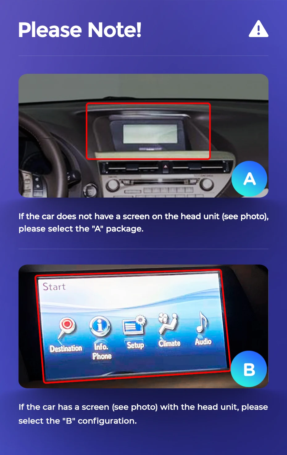

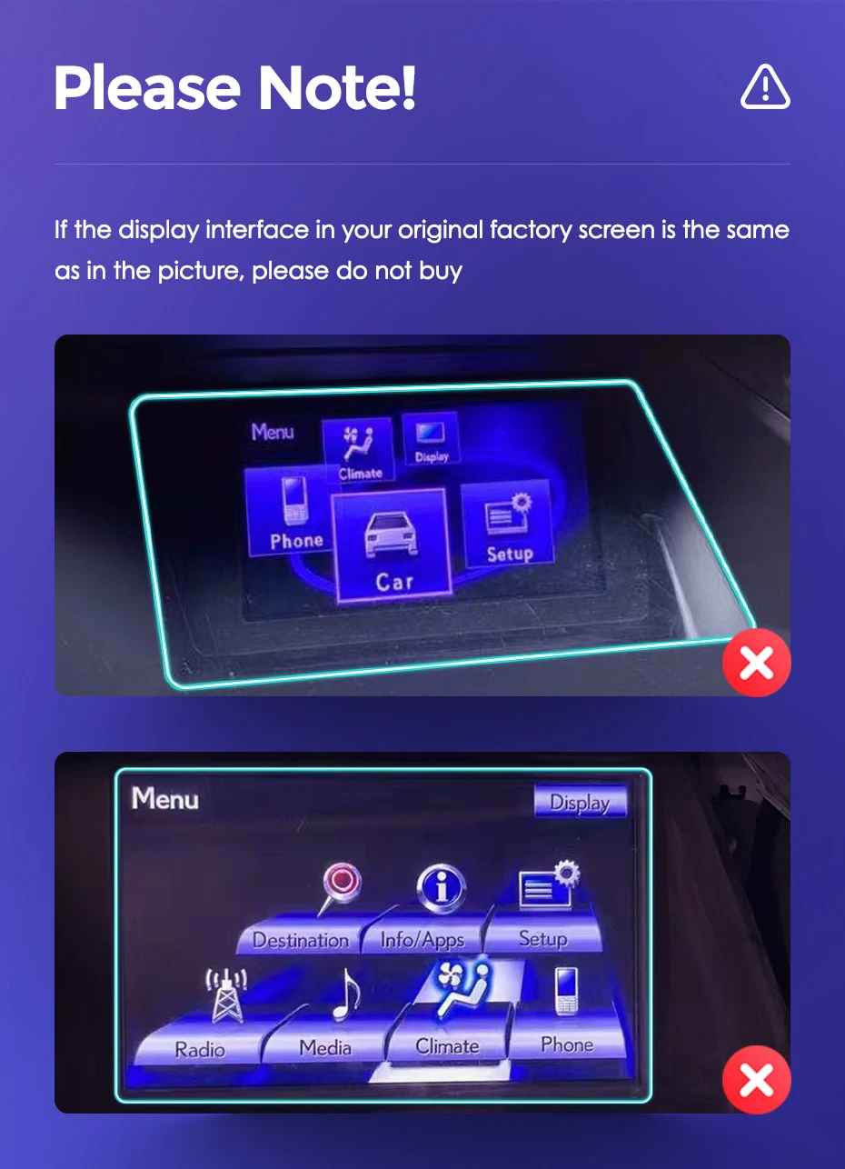

To even consider this teyes unit you'll need to figure out if your RX is compatible, from what I can
tell is that if your menu application looks like xyz then your RX is not compatible. You also need to
choose between A or B configurations Alibaba will walk you through all this though if that's where
you decide to purchase the unit from.
