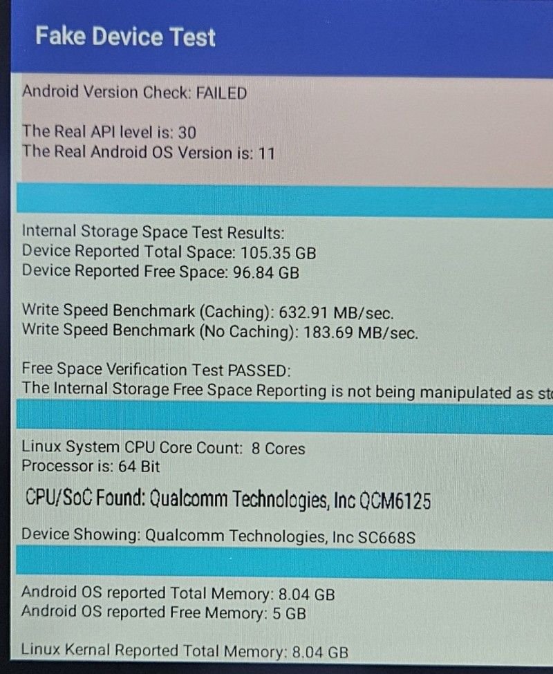

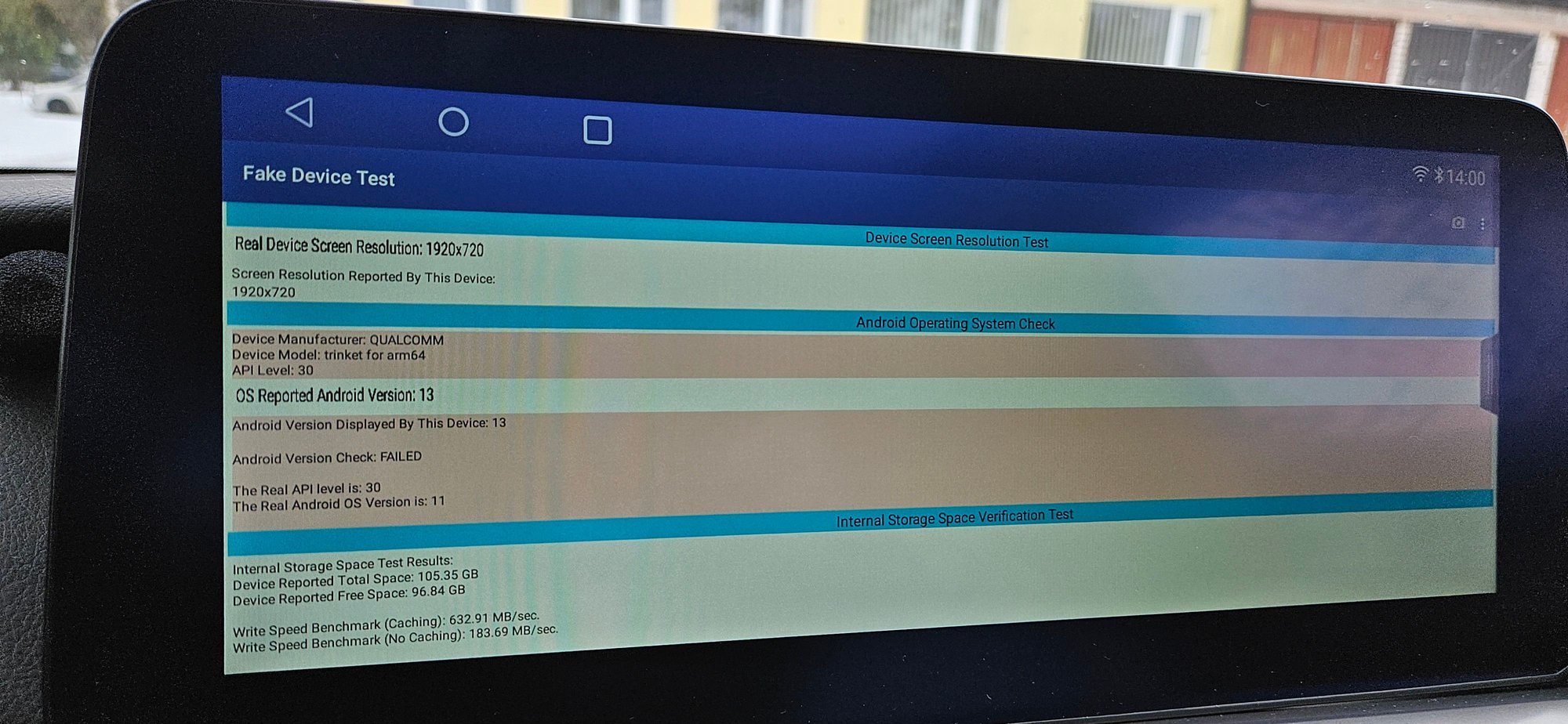

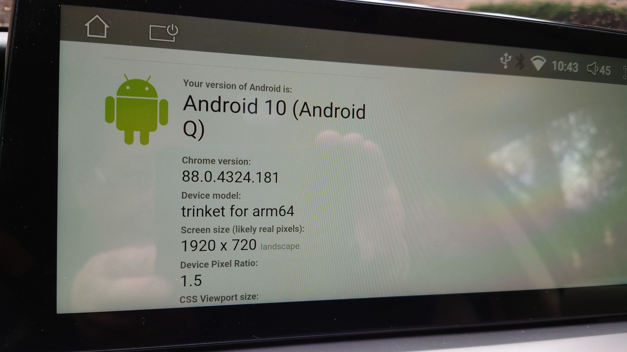

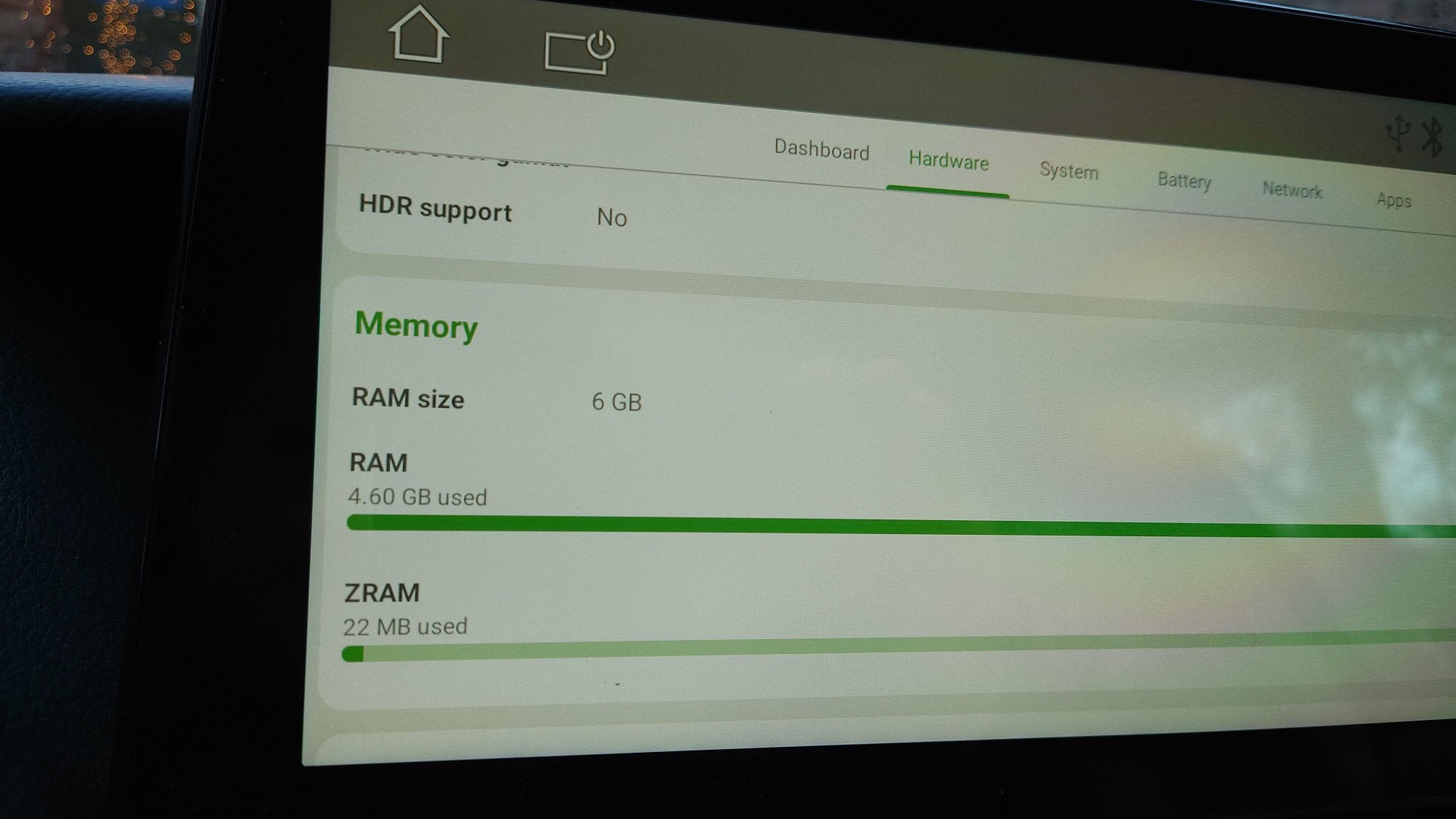

I bought the 8GB & 256GB NAVIRIDER Android 14 unit & installed it myself in my 2011 RX450H.
There are a lot of units out there, which fake the actual ram & memory & android version.
There is a Fake Device Test app, which checks these things, but this was blocked on my unit ( They're getting better at hiding fake units).
I did try another program, and it turned out that my unit is Android 10 & ram is 6gb RAM = 8, Memory 256
But yes, the steering wheel controls do work.
And no, in my case the mouse controller does not work in Android, only touchscreen.
Android auto works good.
I still use the original camera, but when it switches back after reversing you'll get a pink screen flash, as others also have mentioned.
My unit is otherwise very restricted, can not change the Homescreen or the background. Can not install the Lexus animated boot logo, so stuck with android start up screen. Other units can.

Wow, thanks for sharing honest feedback, @animalfarm!
It is worrisome that units come with older versions of Android. Does that mean wireless AndroidAuto will eventually stop working because the phone's and head unit's OS are incompatible?
I guess Apple CarPlay will have the same problem...
That's disappointing for the price they charge.

Not necessarily. I've installed a couple of Android headunits in other cars (kids) and, as long as Apple doesn't suddenly deprecate old CarPlay, you'll be fine.

Update: settled the dispute with the seller, got. $30,- refund.
I could also return the unit at their expense.
The truth is, there are no other units.
I asked them to send the right unit, with 8 gb RAM, but they said there is hardly any improvement compared to the 6 gb version...the only option was to send it back & get the refund.
I like the big screen, Android car works fine. The options on the head unit itself are disappointing.
