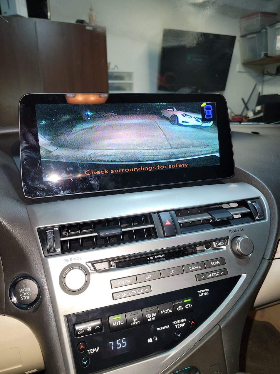

Overall very satisfied, I have the joystick where you can use the original system , I actually have mine go to original screen by default. then switch.

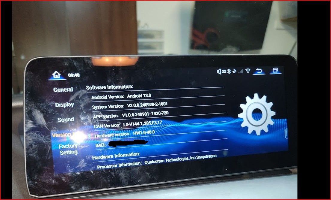

I have the 12.3 inch screen , I will have to use the Fake Android app and i noticed one person had CPZ.... guessing they are from play store... maybe sideloads?
Is anyone on record of actually getting a full refund from AliExpress should it be spec'd different than advertised?????

Original Reverse camera bridged with supplied adapter harness
Specs, I am interested to see how Fake Android confirms this .... If fake I am probably SOL as i can't imagine they will refund unless forced by AlliExpress

OS and Version Information

- The biggest grudge that I have so far is that I don't really see the park assist little popup if I'm in Drive or Neutral. But it does work as expected while reversing. Maybe there is some setting to tweak? Will double-check with the Navirider support.
- Joystick works with the new head unit, but using it is torture. It always goes to the wrong spot (there is no such an issue with the original multimedia)

How reliably does it switch to reverse view camera? In my hybrid I can be in R within 3 sec of Ready (start equivalent).
It works similarly to the native head unit. When I put the car into Reverse, it takes up to 1 second to display the rear space on the screen. That said, if I turn on the engine and don't wait until the unit boots up fully and start reversing, the screen will remain blank and show nothing. Apart from that, I haven't run into any other problems.
