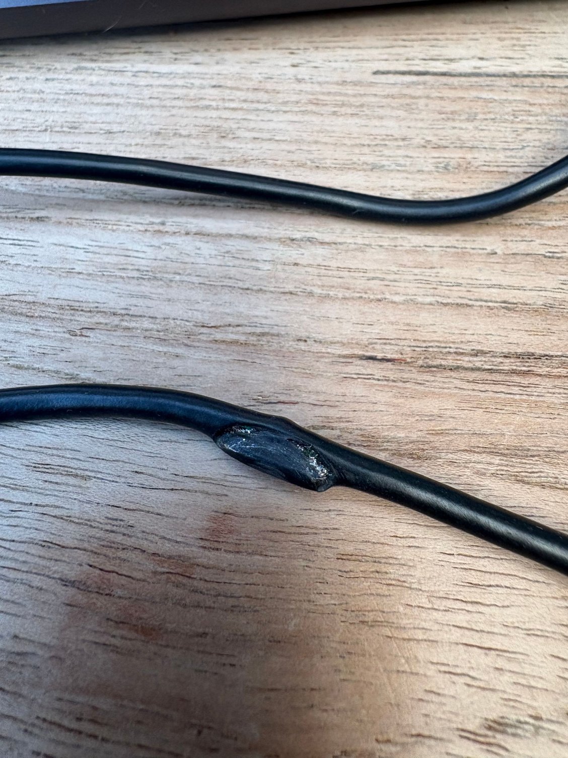

I must say GROM support is great. They have now narrowed it down to an issue with the EU version of the radio so they have developed an EU version of the software. Might take a little while to work out all the gremlins but I am happy to work with them to get to a stable version. I know how well the system can work as the one in my LS430 has been faultless since day one.
Old Jan 2, 2026 | 09:55 AM
  #129
drrishi's Avatar
drrishi
Joined: Jun 2015
Posts: 44
From: ZH
The latest EU update seems to solve the blank screen in the morning issue. The other issues I was having were caused by the display cable which had somehow got crushed during the re-assembly. Lesson learnt here is zip tie everything in a safe position before re-assembly, would have saved me a lot of grief!

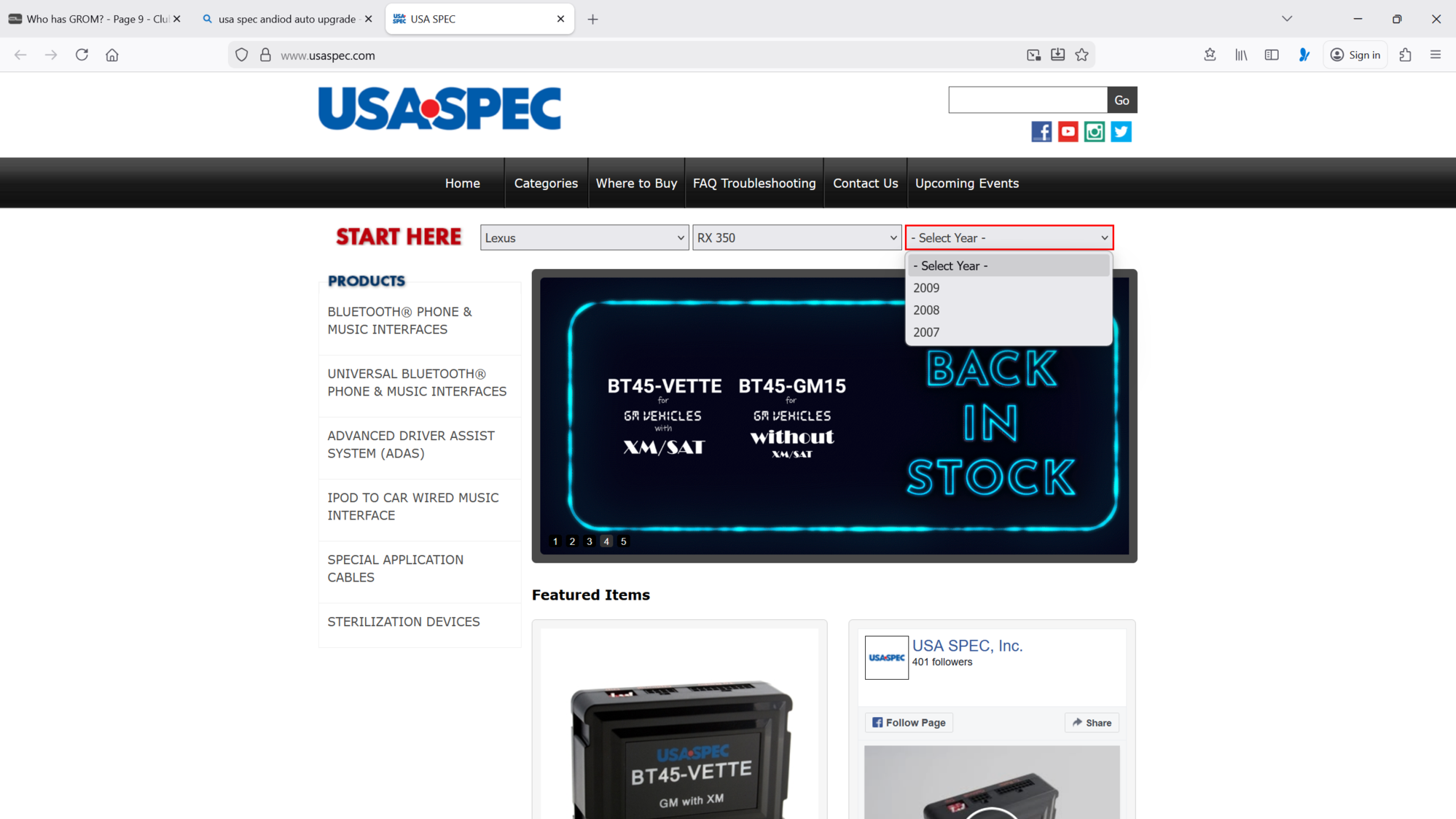

Originally Posted by Hazardlight
My local stereo shop switched from Grom because some customers reported issues. They're now using USA Spec and haven't had any complaints. I've got USA Spec in my car and it's working great.
Interesting.
I just checked and USA Spec do not have any Android Auto integration modules for the 2010-2015 RX350 units or nothing at all it seem. Just the basic Bluetooth add-ons up to 2009.
Post an link to the company units like the GROM please if they exist or the one you claim to have installed in your RX350.
