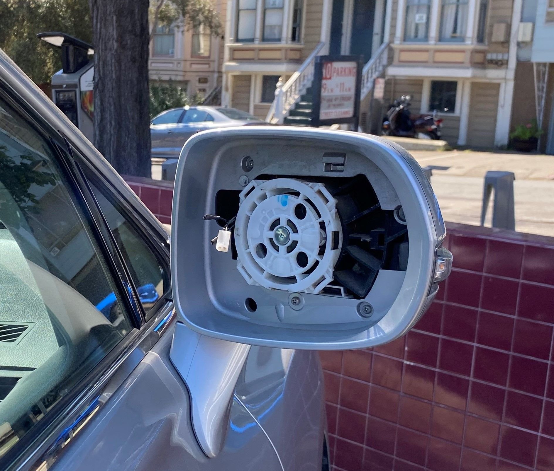

Default Replacing side mirror RX450H
The glass assembly from of side mirror on my daughter-in-law's 2012 Lexus RX450H disappeared mysteriously. See photo. We acquired an entirely new mirror assembly (different color housing, sadly) at a reasonable price, but can't figure out how to remove the glass assembly from the new housing to install in her mount. There's a U-tube that seems to show removal in advance of replacing the glass itself, but does not provide details except to "be careful." The dealer said a new assembly can simply be popped into place. Can anyone tell me how to remove the glass assembly from the new mirror assembly to enable it to be inserted into the frame displayed in the photo?

Look on YouTube for videos on how to change the puddle lights. If you can’t find one for a RX all Toyota’s/Lexus of this year used pretty much the same setup. Basically you have to push the mirror to look all the way up, stick your fingers in underneath and pull forward and upward at the same time. It will make you nervous especially if it’s never been removed but just as your about to give up the mirror will pop out. You will have to undo the wires for the defroster so don’t go to crazy as there’s not allot of slack on the wires. There is a bit of reusable tacky butyl on the back of the mirror. Unfortunately it sounds like someone broke there mirror and helped themselves to yours.
This is on a GS350 but it’s the same clip behind the glass.
https://youtu.be/RqXezUtgieg
