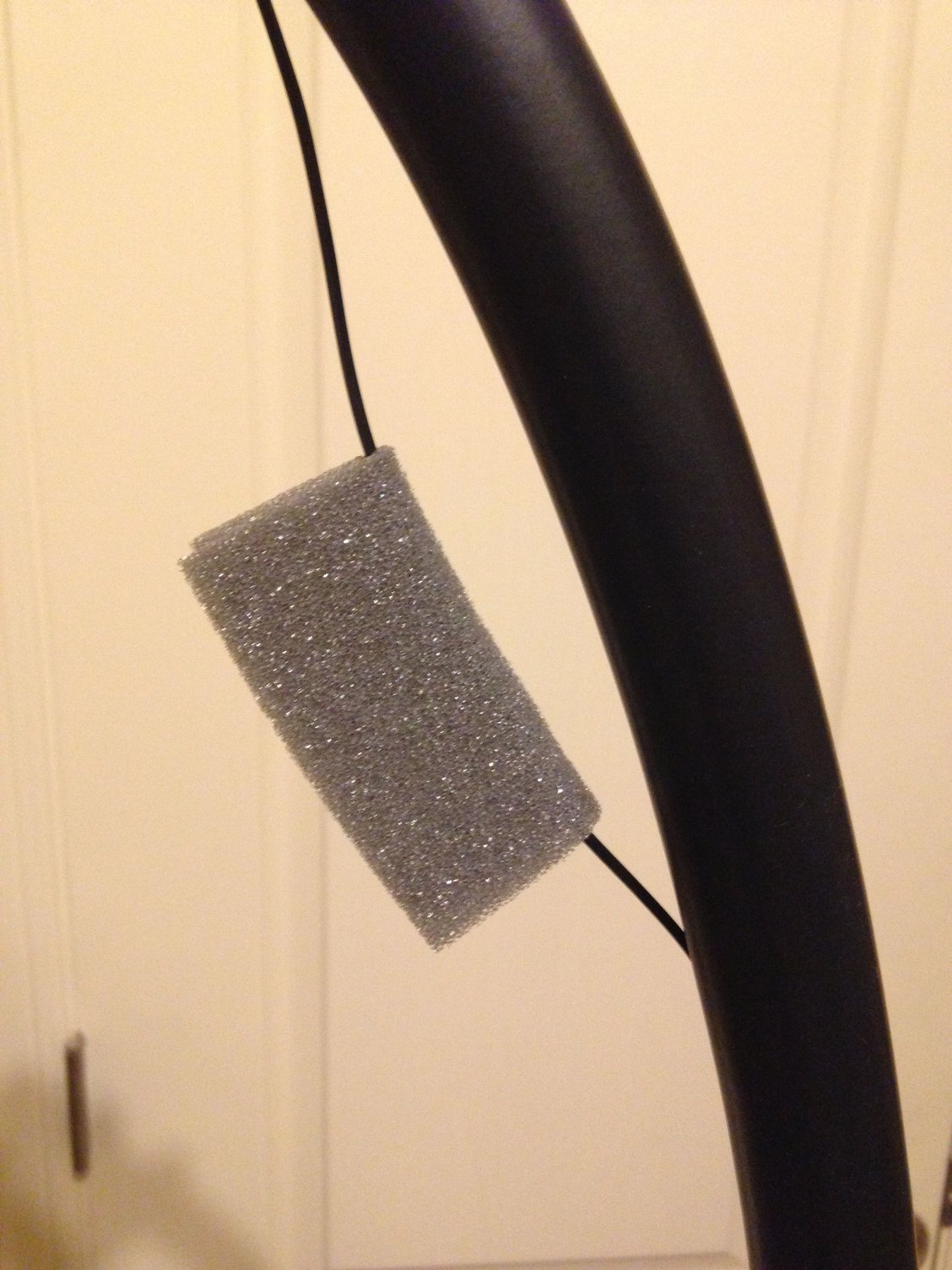

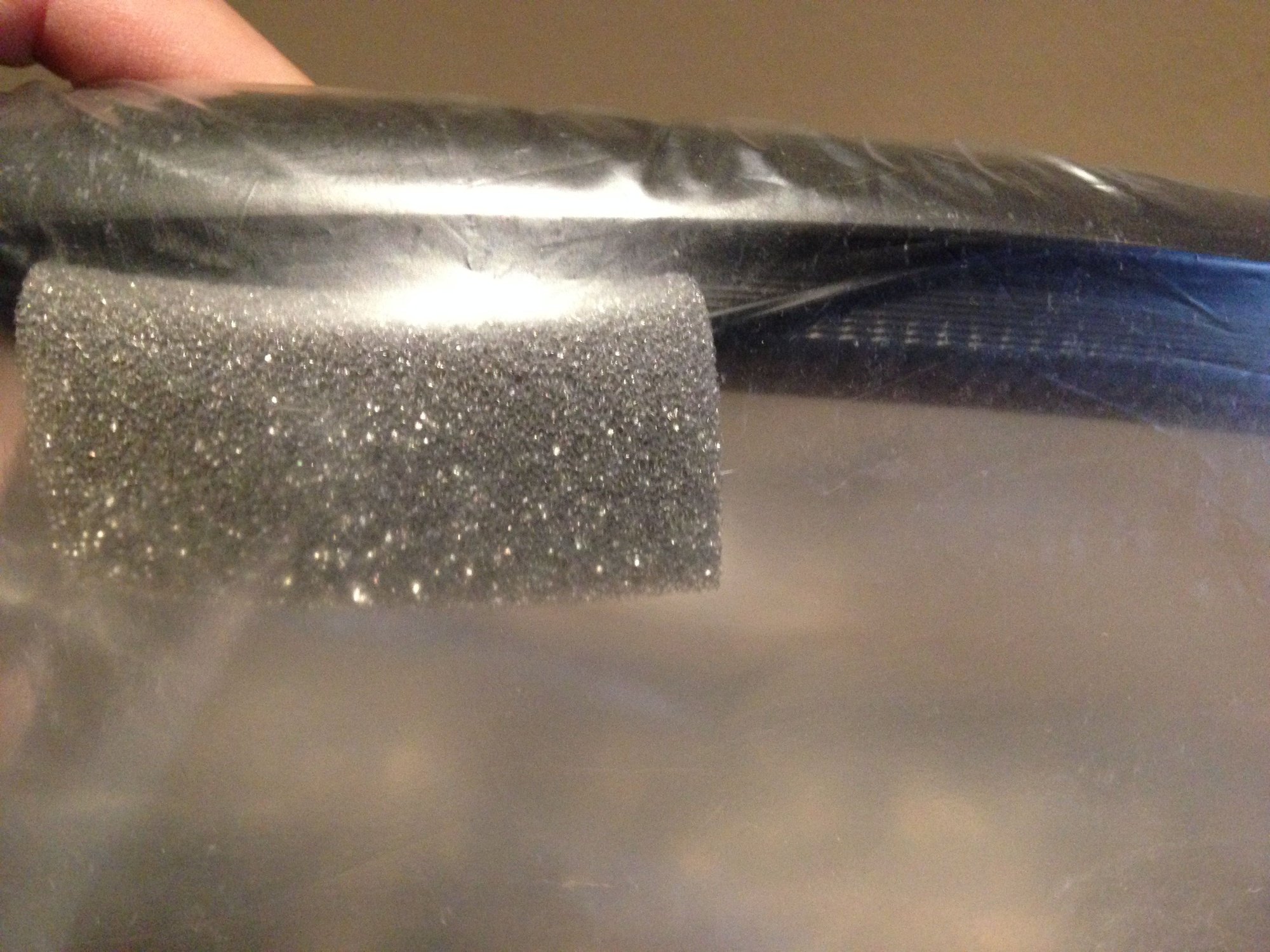

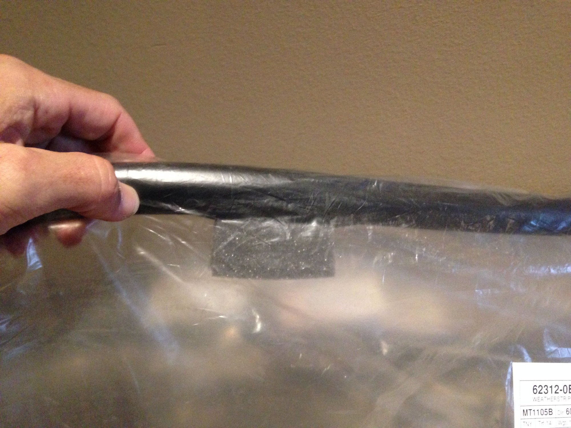

I recently bought 5 body seals. That is all 4 door seals that go against the body and the hatch seal. They are all new from Lexus. There is a peace of foam in one spot of the door seals that I don't know what it does, and am looking for any help in the matter. I tried talking to the techs at my local Lexus dealer, but they didn't know. Hear is three photos of it. I didn't take it out of the plastic, so if the photos aren't clear enough, I can retake them with the seals out of the plastic. Thanks for all your help.

Body shops have more knowledge than the tech at the dealership in this case.
You can find exact answer from Body repair manual and maybes some hint by looking at the part diagram,

I think that’s just to mark the starting point where you install on the vehicle. The corresponding seal on the opposite side should have that foam piece in the same position on the seal. I Replaced door trim rubber seals on one of my cars many years ago and they had a cellophane tape as I recall as the starting point mark. That’s just my wild guess without having it in my hands.

the only thing that i could add is that sometimes the seal becomes 'flat ' and that point may be the cause of some wind noise. The foam inside helps the rubber form becoming overly compressed and not creating a good seal.Do they all have this piece of foam? If so' i would think , like someone else said, it is there to indicate specific step or point.

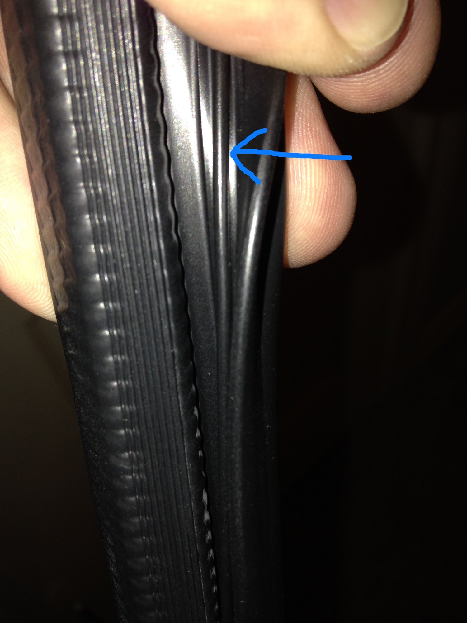

Thanks for all the help. I did go to a local body shop that told me the foam pice and the cord that its attached to is just part of the manufacturing process and gets removed before use. I guess it's there just to hold open a grove or something. Any how, I have a cupel of photos that are a little clearer. Thanks again for all the help. Now I just need to start removing all the panels and such to change them. I was hoping that all I would need to do is remove the sill plates, but I was told that I have to remove a lot more and bull down on the head liner. So much work for getting rid of squeaking seals.

If it was the squeak .. it can be treated with liberal application of talc. Worth try before undertake lot of work.
Not very convincing answer, but body shop is best place to get advice.
