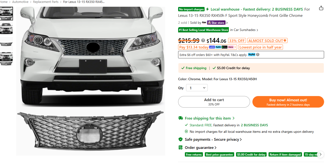

I actually just ordered an F-Sport style grille.
In fact, there are two variants for the facelifted third-generation RX.
You can purchase a used grille from an original F-Sport version (it doesn't matter whether it comes with the chrome surround or without) and simply swap the inner grille insert into your bumper, using your own chrome surround.
Alternatively, you can purchase a new F-Sport style grille, which looks exactly the same but is sold without the chrome surround.
I chose option number two. And I also found the best deal in terms of price! (www.temu.com Item ID: 130G20VXQ)

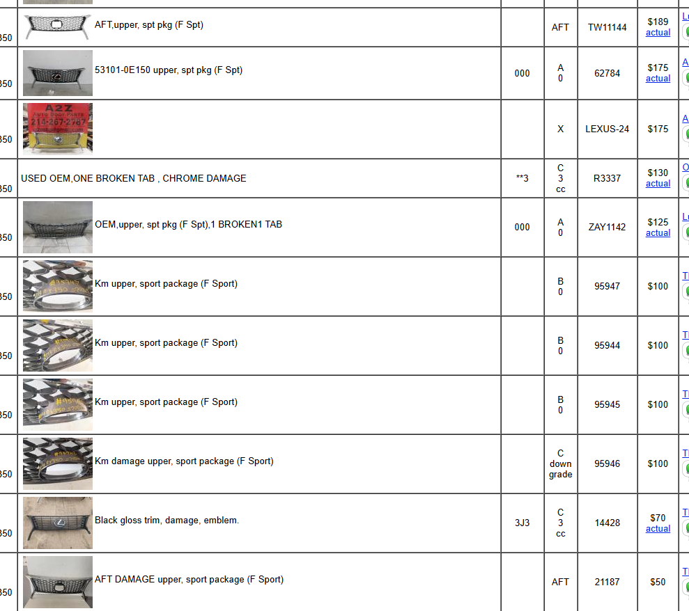

On car-part.com, an original used grille costs upwards of $100, but some of the mounting tabs are broken.

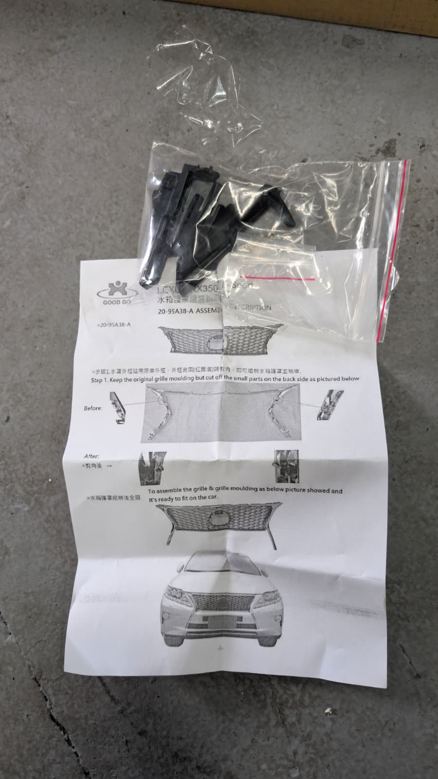

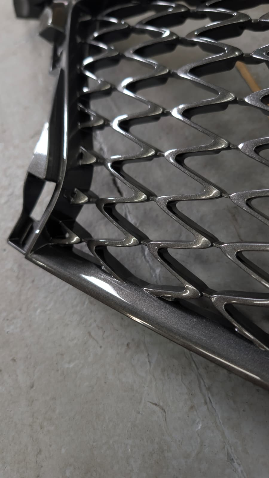

Just received it. It looks cool. I like that it’s a dark color. It comes with instructions (though who needs them?) and extra mounting hardware.
When I install it, I might take some additional photos—someone might find them useful.
p.s. I don't know the exact number of days for delivery—I think it was about a week—but that wasn't important to me.
Grille + Tax — Total $153.42
Free Shipping
