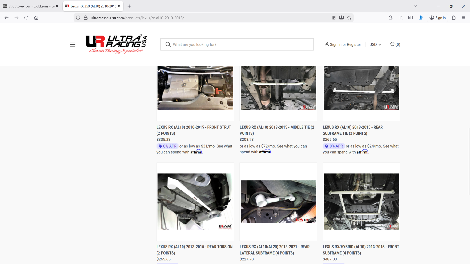

Wondering if any here have installed a strut tower bar on their 3RX and how steering, front body sway and ride felt after installation. Surprised that the 3RX F-Sport does come with a couple of lower body stiffeners but not the strut bar.

A strut tower bar does little for handling, it may make the body stiffer on some lesser quality vehicles, but not a front wheel drive based chassis like the RX which is already beefed up to support the front wheel drive system and Lexus crash worthiness etc.
There are some parts from Ultra Racing and Hard Race, but the front is so stiff on this vehicle that it would not make much difference. Ultra Racing has a front strut tower bar but only for the right hand drive models is the indent for the brake fluid reservoir is on the wrong side.
If you want to improve handling just install Bilstein B6 struts and shocks and maybe the Hard Race rear sway bar.

The RX350 already has an strut tower brace from the factory. The large metal cowl section that hold the wiper motor is also the strut support brace that stiffens the front.
I would buy an rear chassis support brace for the RX350 not the strut tower bar.
This large metal black tray is the factory strut brace on the RX350

Thanks Carguy I see how that tray ties the 2 strut towers together now and why 3RX F-sport doesn't include an additional bar stiffener in that area, good call on rear brace.

I will buy an rear torsion bar first and see if that make any improvements on my RX350 as my rear end seem to have a bit of sway around corners. The front end on my RX350 seem pretty solid with no swaying or body roll.
However I do have 20in wheels with 255/45-20 tires so my RX350 does have a bit my stability than with the narrower stock 235/60-18 tires.
