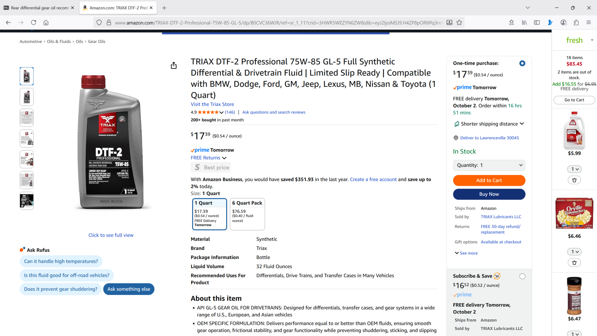

If I really just had to use a 75W-85 gear oil in my RX350 I would just use Triax 75W-85 gear oil. Good fluid that works well and is affordable. I use Triax in my 2020 Alfa Romeo transfer-case that calls for 75W(or 75W-80) gear oil.
