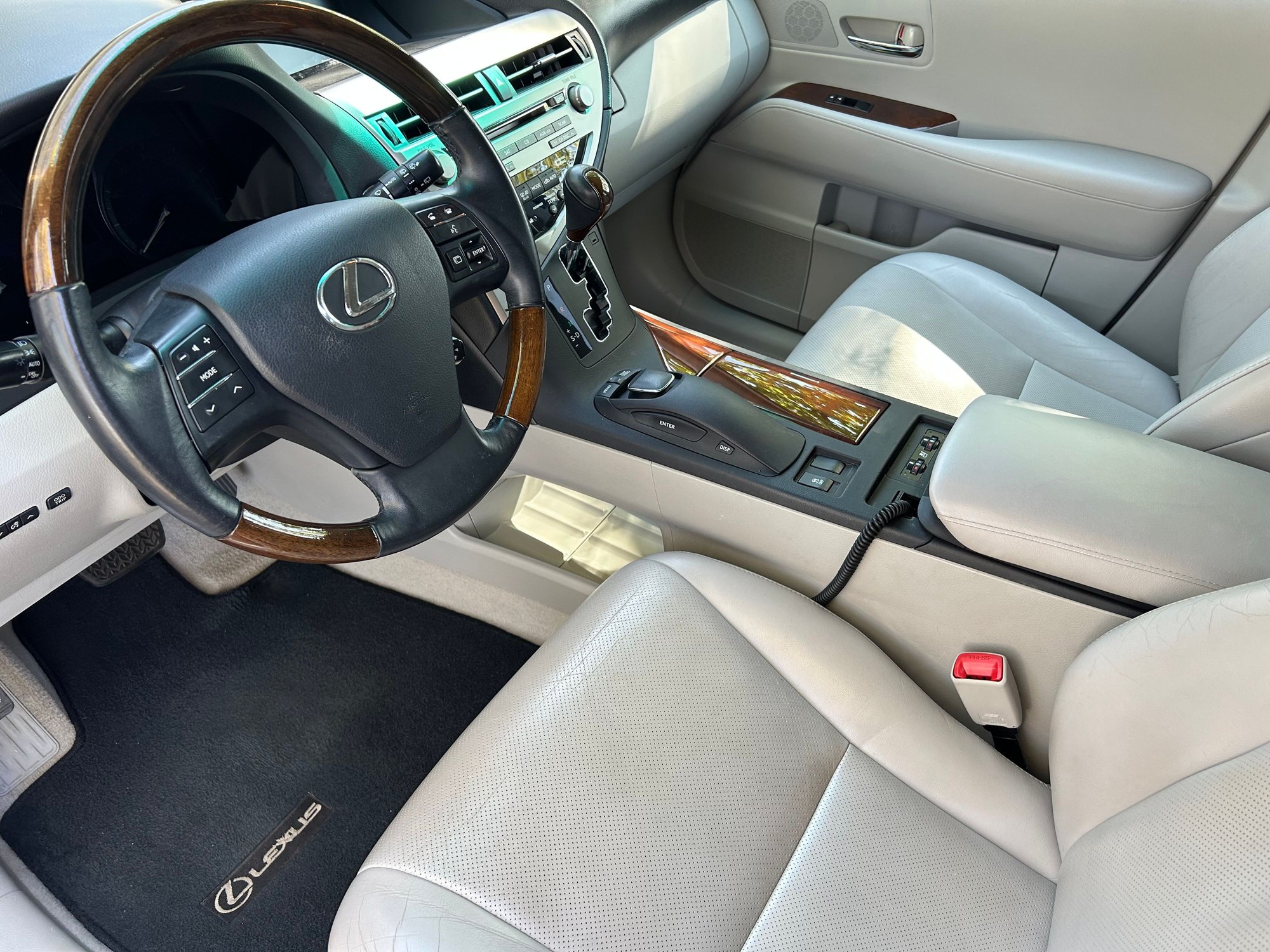

Leather renew is for painting the entire seat. The kit provides all you need. Get the brush on kit, not the spray. You clean and lightly sand the dirty cracked seats, then paint several light coats. Then finish with the clear coat which they sell separately as an option. It makes the paint last a lot longer. If any gets into the ventilation holes, use a toothpick to clear them. See the links posted above to threads with before and after photos.
In 2015 I Idon't recall a 3rd gen touring package. All were the base trim which had cloth seats, to which most dealers added the Premium package which included leather seats.
The rare top of the line edition got some Premium leather. Whatever it is, it is not very good and the stuff in my 2016 Toyota Sienna is much better.
So this vehicle has leather seats.
You should make the folks who had your car pay for a professional detail shop to clean it up.

You have leather seats. You do not have nulux. Your interior looks exactly like my 2010 in Parchment.
In 2015 all the RX models were the base trim (except F Sport) which had cloth seats, (which no dealer ordered and I have never seen) to which almost every dealer added the Premium package which included leather seats and other nice stuff.
The rare top of the line edition got some thicker Premium leather.

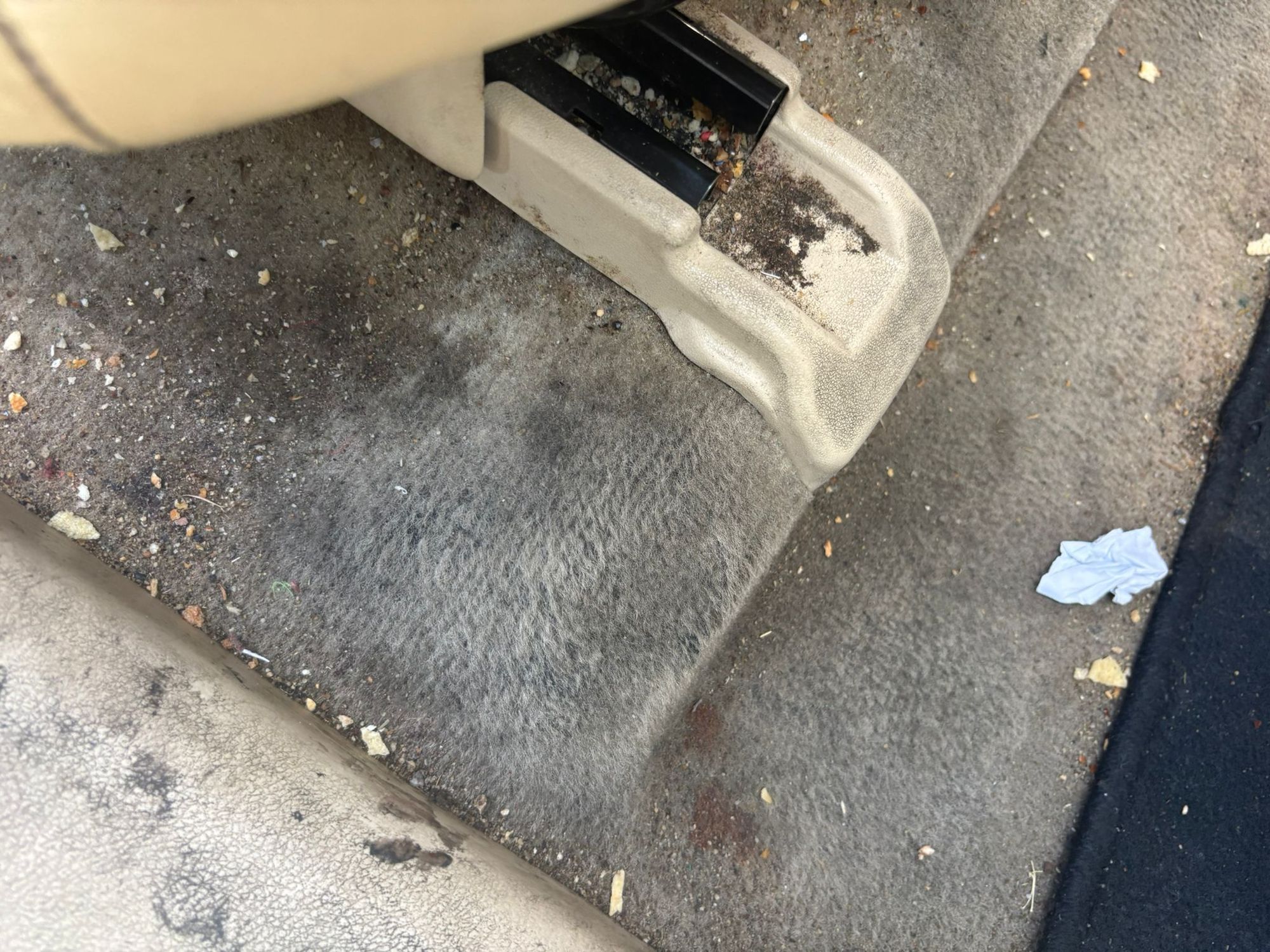

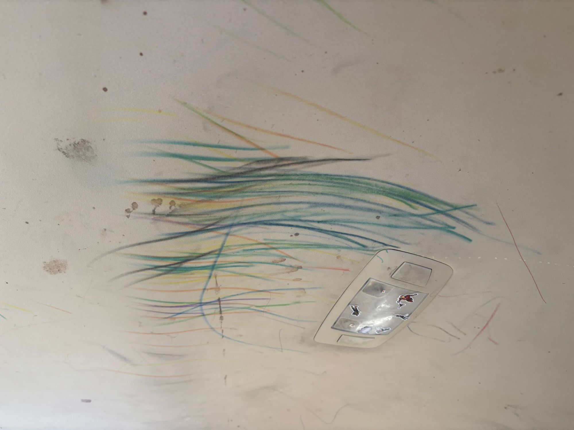

I have a 2015 RX 350 whose interior is in a poor state. There are marks on the headliner, and the carpet is very dirty. I can vacuum it but need a way to make it clean.
Can you suggest products that can help clean it (the cleaning product in the house does not appear to work, plus I don't want to spread the marks when I try to scrub it clean)
I don't plan on hiring the car cleaning person, as they are quite expensive in my area.
The car is in California/USA

thanks. I can clean the roofliner using Folex carpet cleaner for the fabric surfaces, such as the roof liner and pillars. I bought one, but i ran out and now ordering a two-bottle set so that I can clean the rest of the car and my second car.
Regarding the suggestion about the leather seats, which are also in a very poor shape. Is Formula 409 a good choice for cleaning and clearing the dirt from the cracks? How is the leather renewal kit? How can I be sure that the dyed color matches the color of the seats? I only intend to dye the affected area?

You have the Parchment interior and their color guide is accurate. You have Parchment which is their color 2134.
https://leatherrenew.com/products/au...ithout-sprayer
https://leatherrenew.com/color-chart.../20-lexus/file
https://leatherrenew.com/products/si.../leather-clear
Be sure to get the top coat clear coat as it makes the new paint last a lot longer.
I think painting a section will match the remaining seat. Their color mix is excellent, but why not paint the entire seat. Get the kit with the foam brush as it is too sloppy to try and spray the interior. Use a few light coats of paint. It dries quickly.
You can try cleaning a small section of seat with 409 and a toothbrush, or even try the Folex, but be sure to rinse with water afterward and dry it right away. However it may change the seat color a bit.
