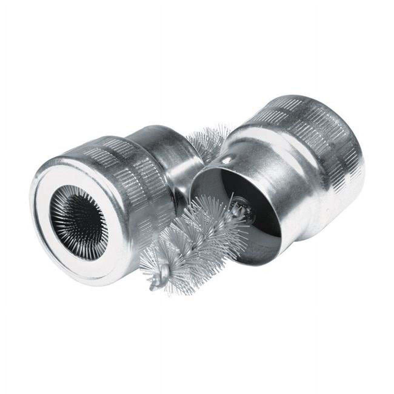

None of my cars (7) have battery terminal and post corrosion I don't put anything on them. BTW your link says to use a wire brush to clean battery terminals very bad advice. Use a Scotch-Brite pad combined with chemicals if necessary far more effective and doesn't remove a large amount of material like these stupid things do.
None of my current 6 vehicles or past vehicles have or had battery corrosion. Sorry I don’t have 7. Well I do have 7 if you include the 3 batteries in my boat.. 2 house and 1 start all VLRA.
Agree to disagree on the the wire brush vs scotch pad. A scotch pad can remove plenty of material if used vigorously. But if you need to find a fault in my point.. fine. To each their own. I am 100% not “masking” a problem by using battery terminal protectant. Which was your original point. Chemicals?? What chemicals??
