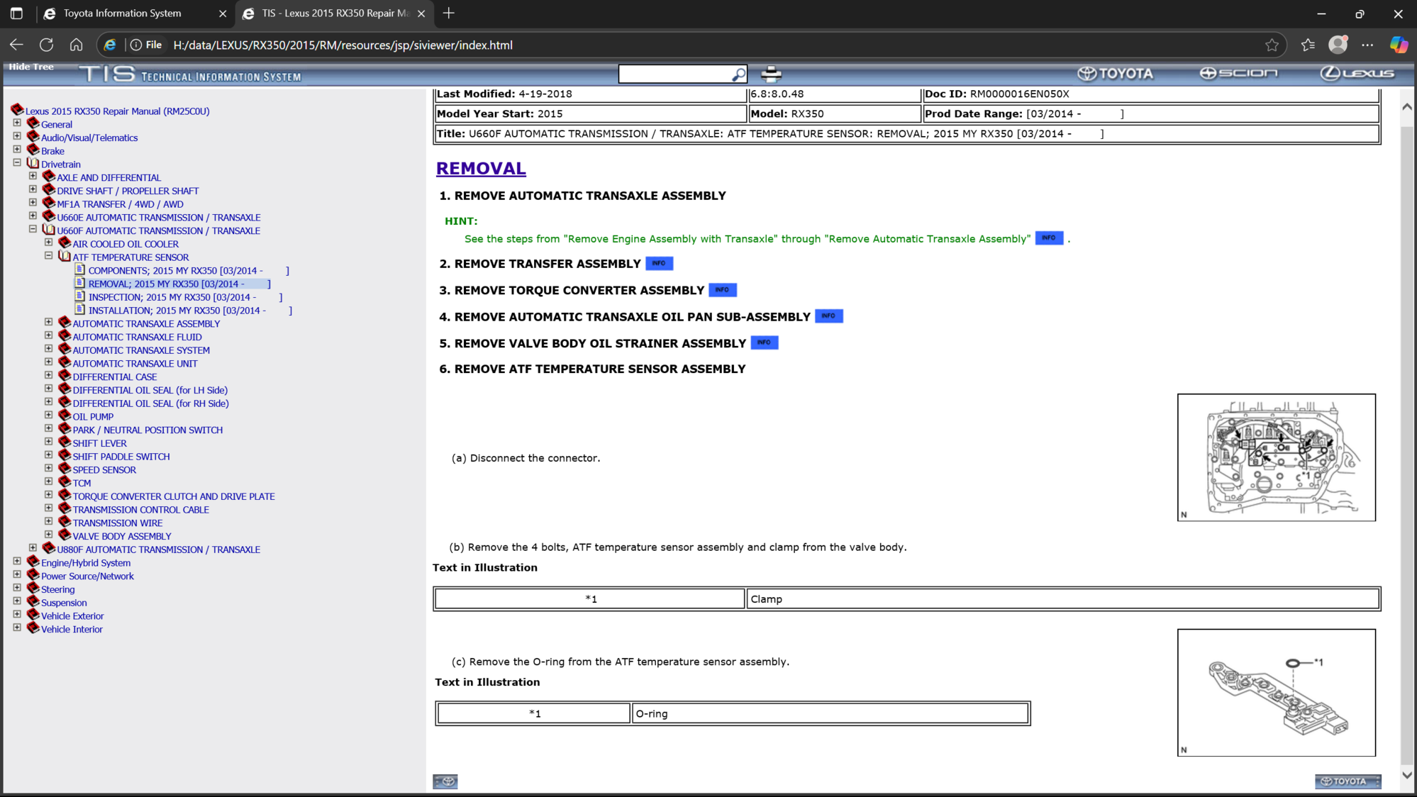

You need to get a second opinion from another transmission shop or independent Toyota specialist as this guy (is it a Lexus dealer?) appears to just want to make a lot of money from you.
This transmission is the U660E model and is used in a bunch of Toyota and Lexus vehicles.

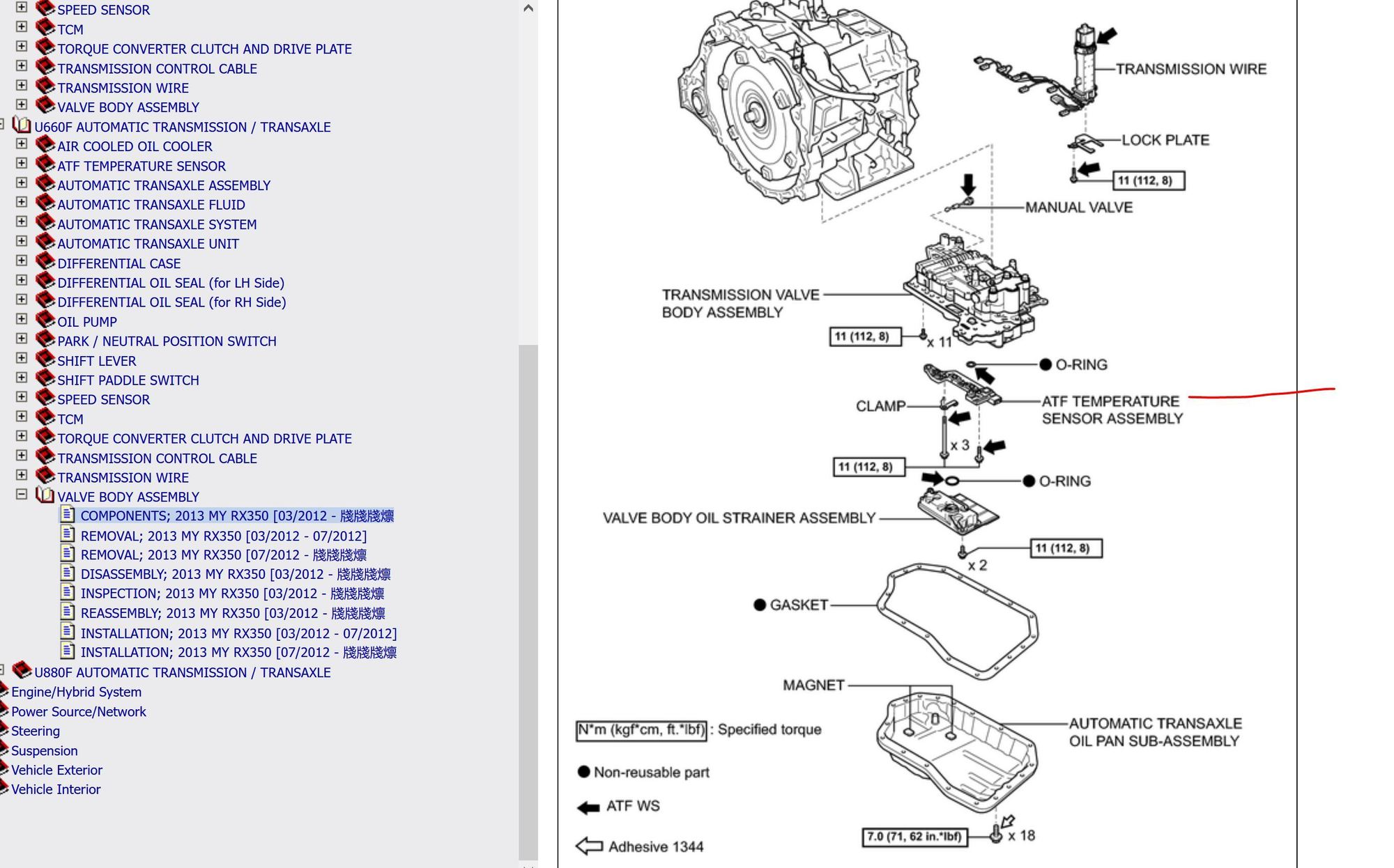

This article states it is on the valve body. There is a kit with the pressure switches and temperature sensor together.

It will be a bit of work such as if performing an transmission filter replacement to replace that sensor, but not require an engine/transmission removal.
The 8 speed is a different story as it is very hard to remove that front mounted transmission pan due to limited space in which jacking up the engine does not work. One of the reasons I did not pick up an 2013-2015 F-sport model with that 8-speed transmission.
May as well replace this while they are taking the pan out: Cost is about $100. It fits both the U760E and U660E

Frankly, $4500 to replace this is a ripoff. There is NO need to remove the engine/trans cradle to get to this sensor if you have the 6 speed (U660E or u660F). I cannot speak for the U880F (8 speed/AWD), as I haven't worked on one of these.
