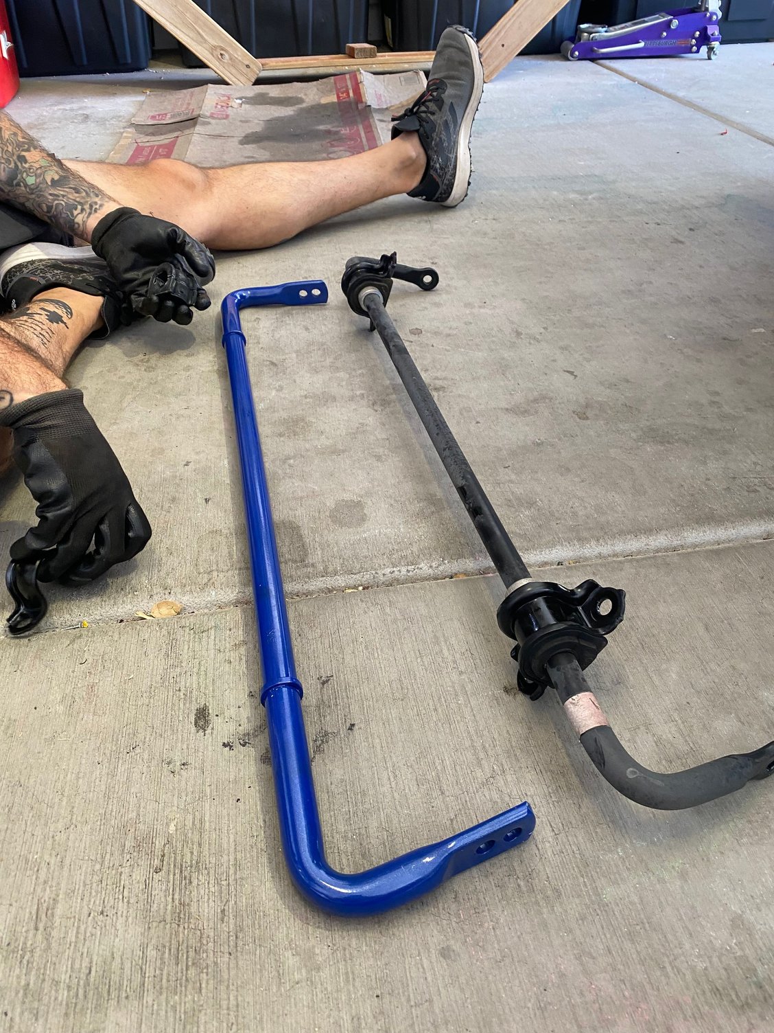

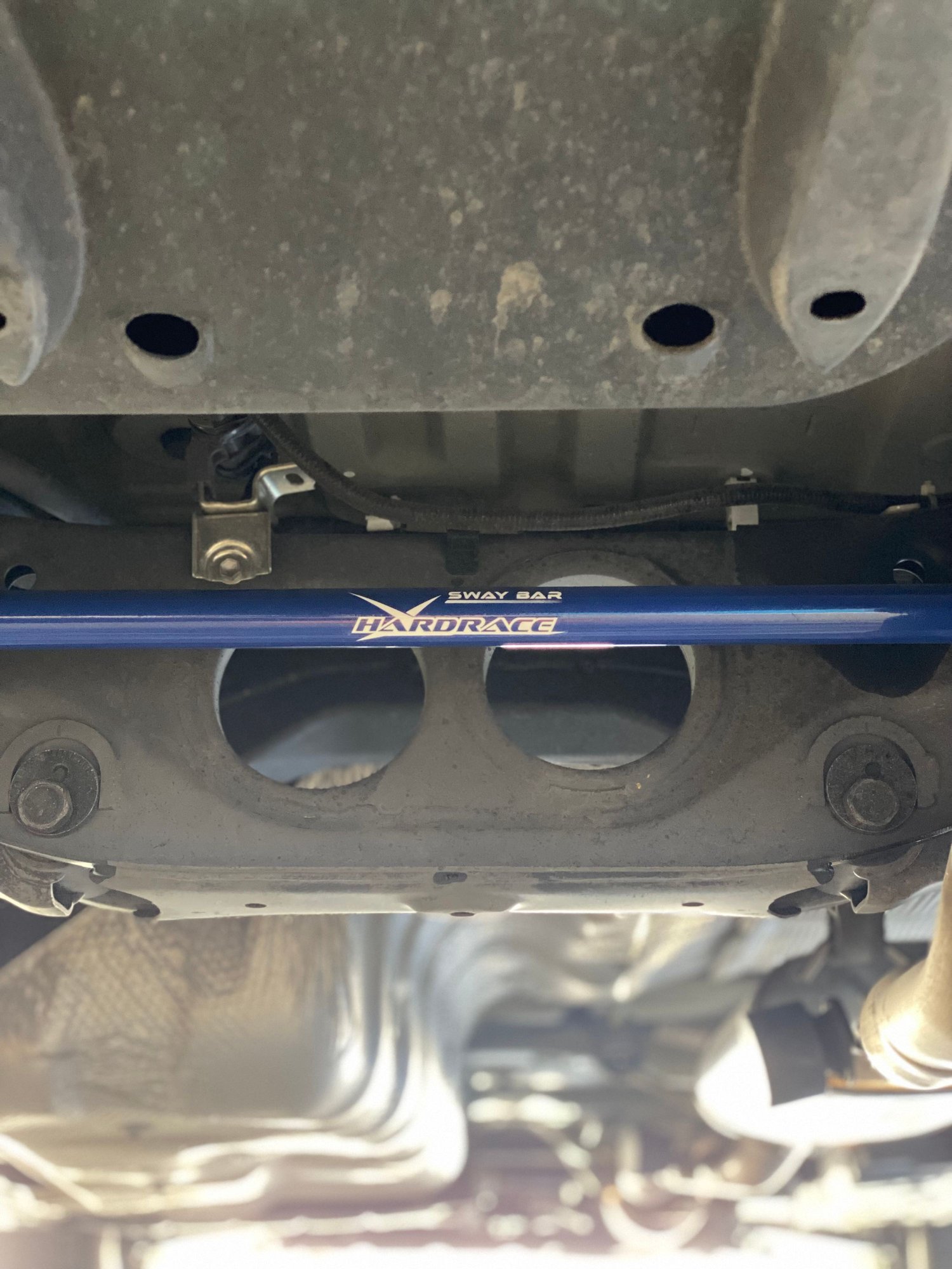

just installed the Hardrace rear sway bar on the 2015 Lexus RX350 fwd. Excellent fitment and improved handling. Recommend

Yea easy DIY crawl under with rear on ramps done in 1 hour.

bar installed and is great. Steering response improved less body roll.

This ^^^^ Corner exit greatly improved as well as corner entry push reduced. Good time to replaced the end-links.
