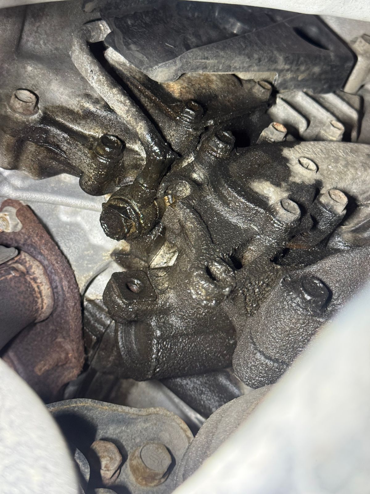

Here is the same seepage on my 2010 RX450h that the garage took a photo of when I was getting it looked at for water pump replacement. While up on the lift , very easy to see and get access to. Never found a oil spot ever on my driveway, so I’m leaving well enough alone
Just a guess, but it looks like you may have a couple weeping gaskets or seals. It seem like the cam cover seal(just over the water pump under the plastic cover) is leaking as well as the banjo bolt or timing cover. The timing cover seal tend to leak behind(and above) the banjo bolt and look like an banjo bolt leak, but it seems that your banjo bolt is actually leaking due to excessive amount of oil on the line itself. Usually an timing cover leak will have more oil on the timing cover under the banjo bolt.
To be honest your RX350 can have a weeping leak on the timing cover, the banjo bolt, and the cam cover all at the same time. They are all common leak points on this engine.
I would clean it up and see how long it takes for the oil residue to return while keeping an eye on your oil level.
