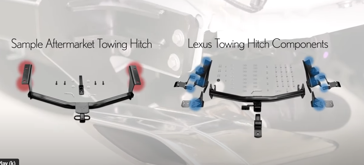

I installed the OEM hitch (PT228-48210), which secures with 10 bolts—six perpendicular to the ground and four parallel. The installation requires two adapters that replace the OEM tow hooks, removal and reinstallation of the bumper cover, and replacement of the aluminum bumper. It also includes a built-in wiring harness.
This differs from aftermarket hitches, which typically use only four or six downward-facing bolts. While it’s possible that Exactly installed a different OEM hitch, it’s more likely they used an aftermarket option like Curt or Draw-Tite, which are much simpler to install.
Here’s a picture from a Lexus video that highlights the differences between the OEM and aftermarket hitches. (The image is not of an RX hitch, but it is close).

TriRex is correct - I misspoke. I will revise my original reply (as I hate being misled on line and I apologize if any churn resulted from my initial response). Well done, TriRex in correcting this for other's benefits.
