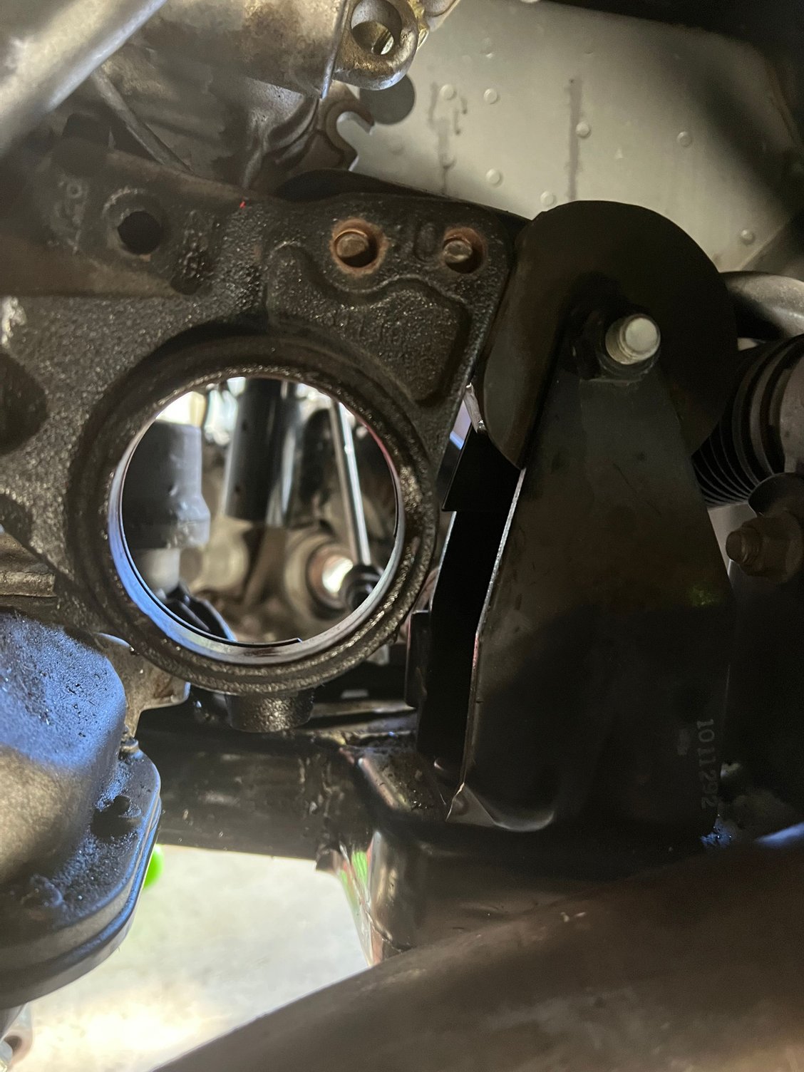

I spent the past 5 hours trying to get this out....tried pry bar, hammering with a chisel, pb blaster soak, slide hammering tool from autozone....still won't budge...is there a special trick?
is the carrier bearing pressed into the bracket/holder? I'm tempted to cut/sawzall the axle at this point...aaaargh

Try an M10x1.25 bolt, one longer than the original that goes into the bottom of the carrier bearing bracket* sometimes this moves the bearing enough to make it free. If all else fails then cut the axle that's what I do.
*make sure the rubber plug is removed first.
edit - bearing is not pressed in meaning friction fit, it slides into the bore easily assuming the bearing and bracket are not rusty.

Does the passenger side have a support bearing?
Salim

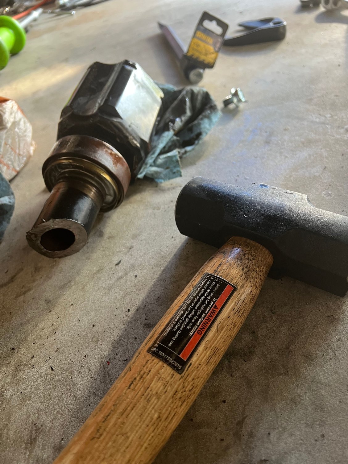

Default Finally!

That's what I do! If I can't get the axle out after a few minutes using the usual methods out comes the angle grinder. Your bracket/mount looks good very little rust now imagine a salt belt car it can take drastic amounts of force to get the bearing out.

congrats on the removal. how long did it take to saw zaw thru that? A man has to be pretty motivated to start saw zawing under a car in tight quarters, must have been angry!! mine likes to kick back on me, gets scary sometimes.

lol…yes first time saw zawing on a car! Took about 15 minutes and had to swap out a new blade…after cutting thru the axle, started hammering away but the bearing still wouldn’t budge…started to worry about how to get the car out and drop off with a mechanic…but I noticed the spacing between the bracket/holder and axle cup had widened a bit so got back to hammering and eventually slid out…

ya, you won't want to bring the car to a mechanic with a only half an axle stuck in there, their charges double after seeing that, not to mention the towing charge! not surprised you needed to change blades, that is some pretty thick metal. now we all know what is inside the Toyota axle !
