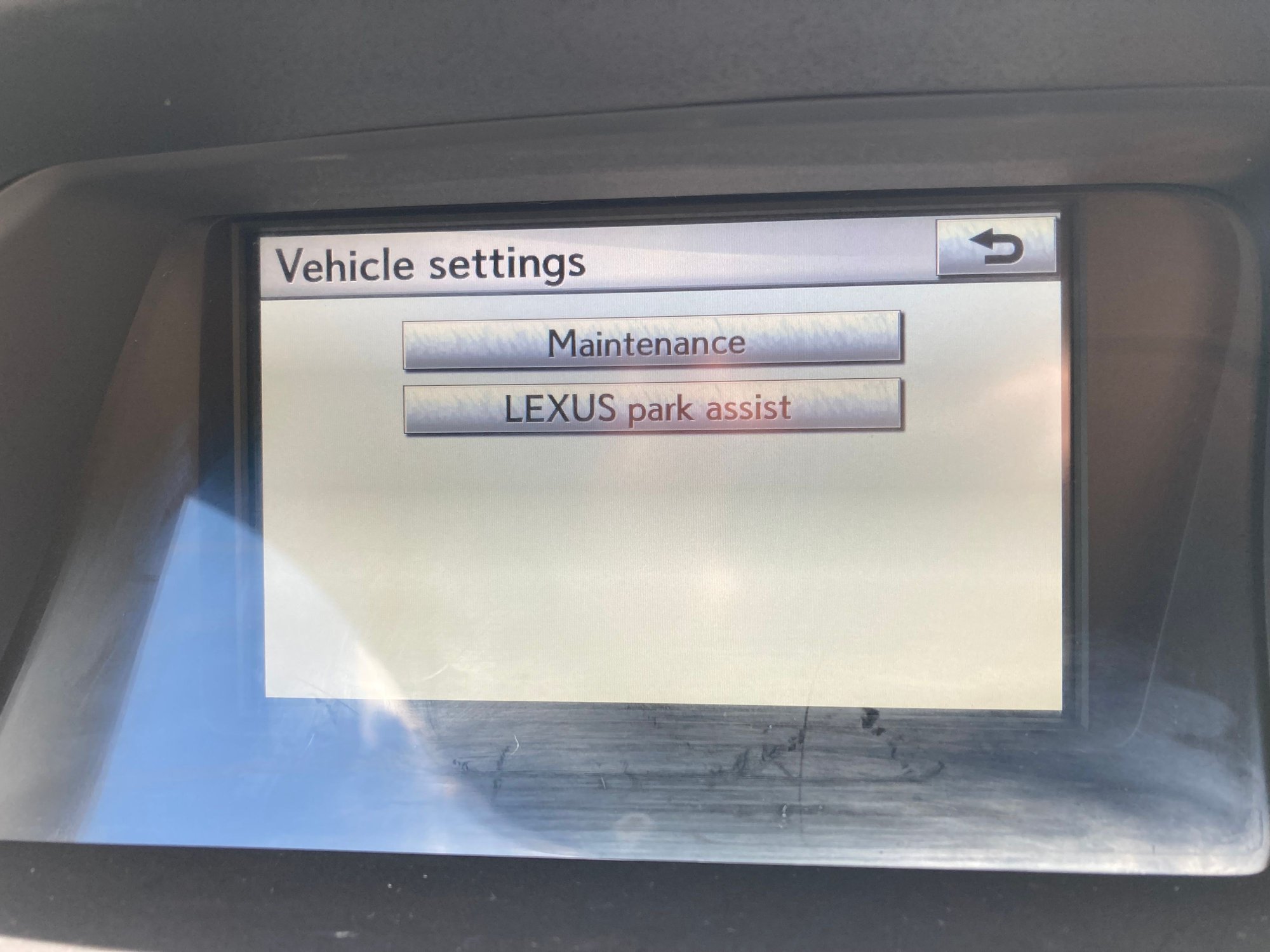

I have an NZ new 2010 RX450h Awd. How do I turn off the function where the drivers seat and steering wheel move when starting the car or plugging in seatbelt? I’m only 165cm tall so don’t need the seat to move when I get in and out of the car. I have been through the manual and can’t find any instructions. There is no option for this on vehicle settings screen.

I have navigation but there is no option to change in vehicle settings. The pic shows the only options I have in vehicle setting
s

The feature is Exit and entry assist.
