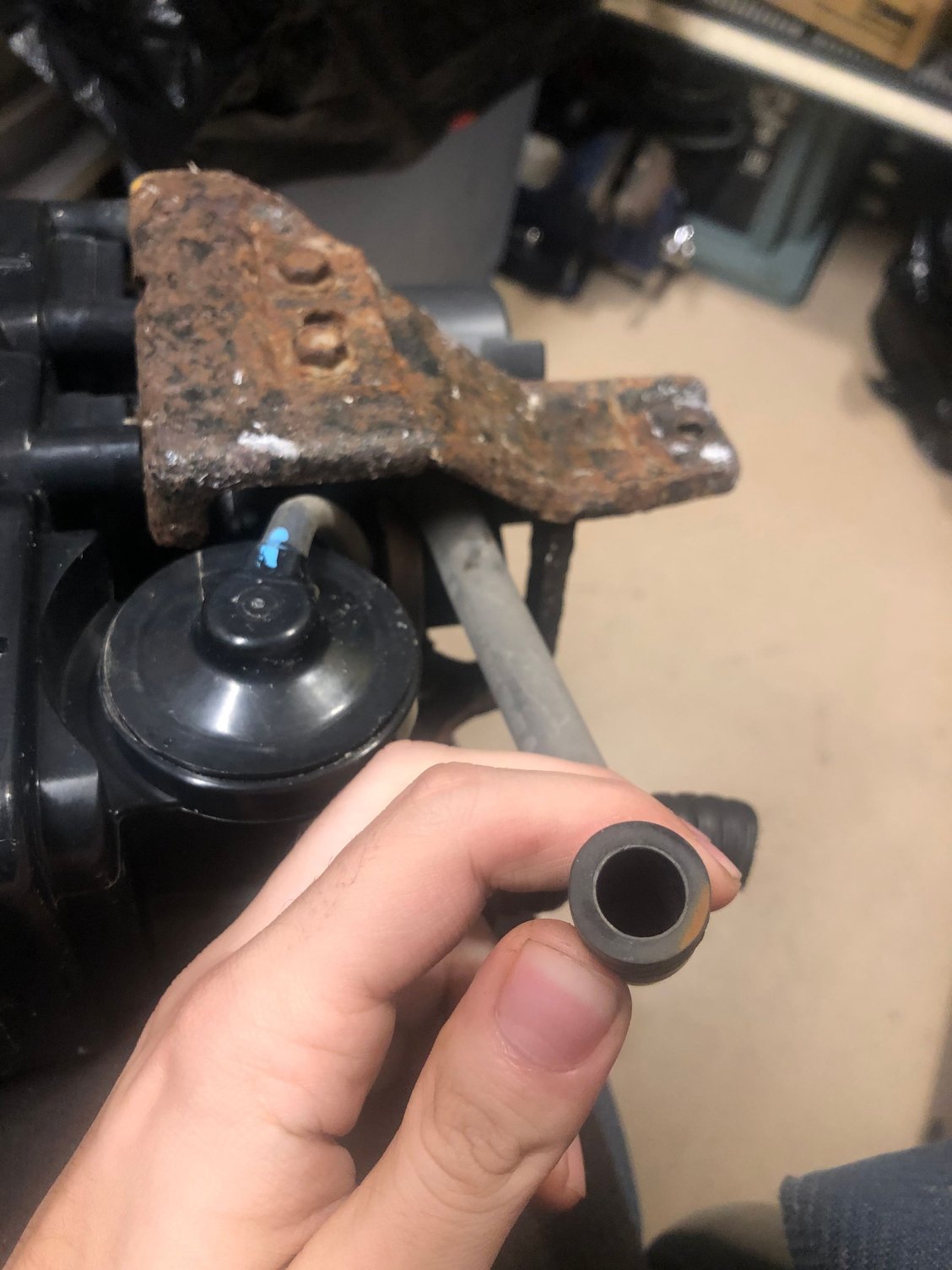

It really is easy. Toyota made it simple for us. The canister only takes 30 minutes max to remove from the car. Then, the VSVs and purge can be bench tested. The hoses can be inspected and replaced accordingly.
19mm fuel hose goes here
3mm hose here
10mm or 3/8” hose here
