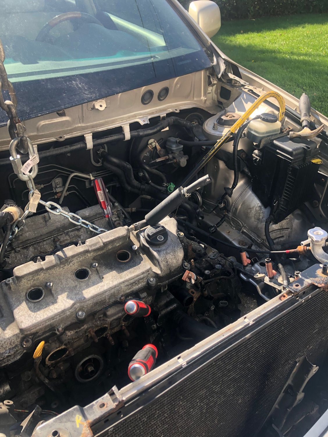

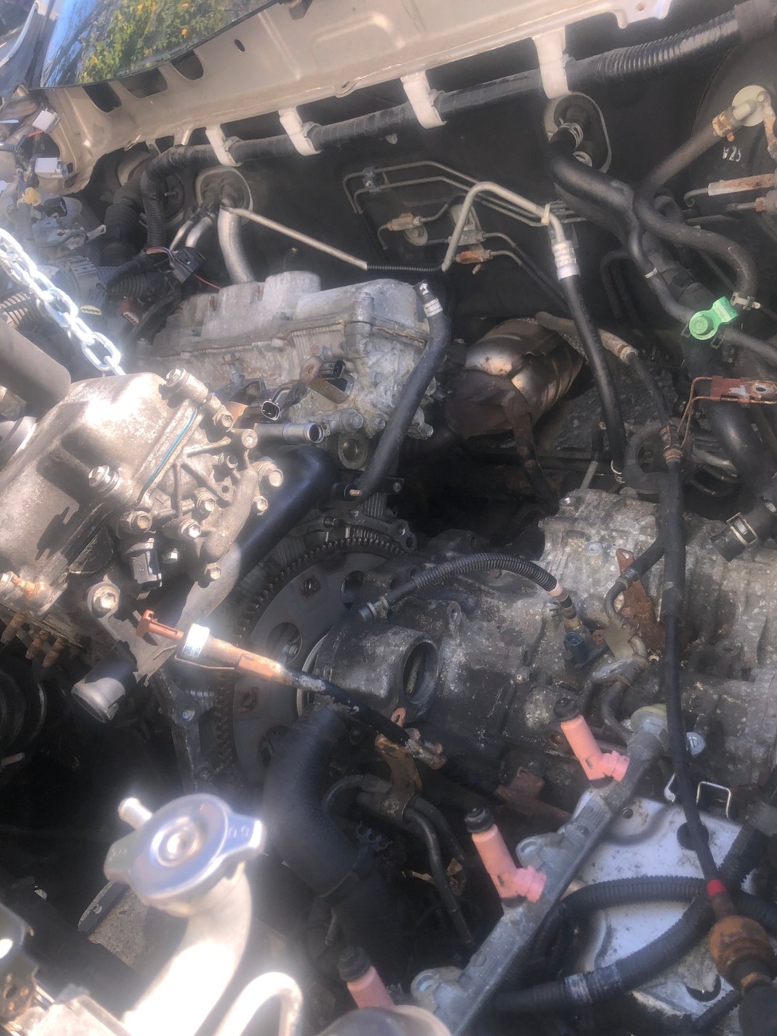

Default 3mz-fe engine removal and swap progress 10-9-22
So today I got to it early and that was a good call because it seems progress is slower to move the more progress I make.
I finally figured out I don’t have to remove the intermediate shaft from the steering gear since I am hoisting the engine out. But now I’m struggling with the exhaust manifold. Specifically cat bank 1 on the back of the engine. The exhaust y pipe fastening flanges and particularly the bolts and nuts holding them are rusted to a flakey iron oxide color that is just indicative of née England wether.
so today I was able to remove cat bank 2 from the front of the engine. I took out the radiator fan to get enough room to do this. Wanted to remove the radiator but it’s stuck somewhere and I really don’t think it’s necessary.
I pulled out the driveshaft before all this marking the direct position it was in when removed and in relation to where it inserts into the tanager case. I removed the valley from the middle top of the engine and got the 2 electrical connections in there.removed the back fuel injector and coil pack connections. Undid the clips holding the wire harness to the timing cover. Undid some other various hoses. Also took off the torque converter access plate and the torque converter bolt but I’m not sure if I had to do this since I’m most likely taking the engine and the transmission out in one piece since I think that it will be easier to attach them properly outside the engine.
if anyone has any tips to save me frustration on the back exhaust manifold/ cat bank I would appreciate it. Looks like I’m going to need to get a heavy duty blade for my multi tool to cut the old nuts and bolts off. New pipe would be optimal but my budget is low and I feel some high heat oil paint and some wire brushing to salvage these components will be the cheapest way to go. Damn you New England weather!

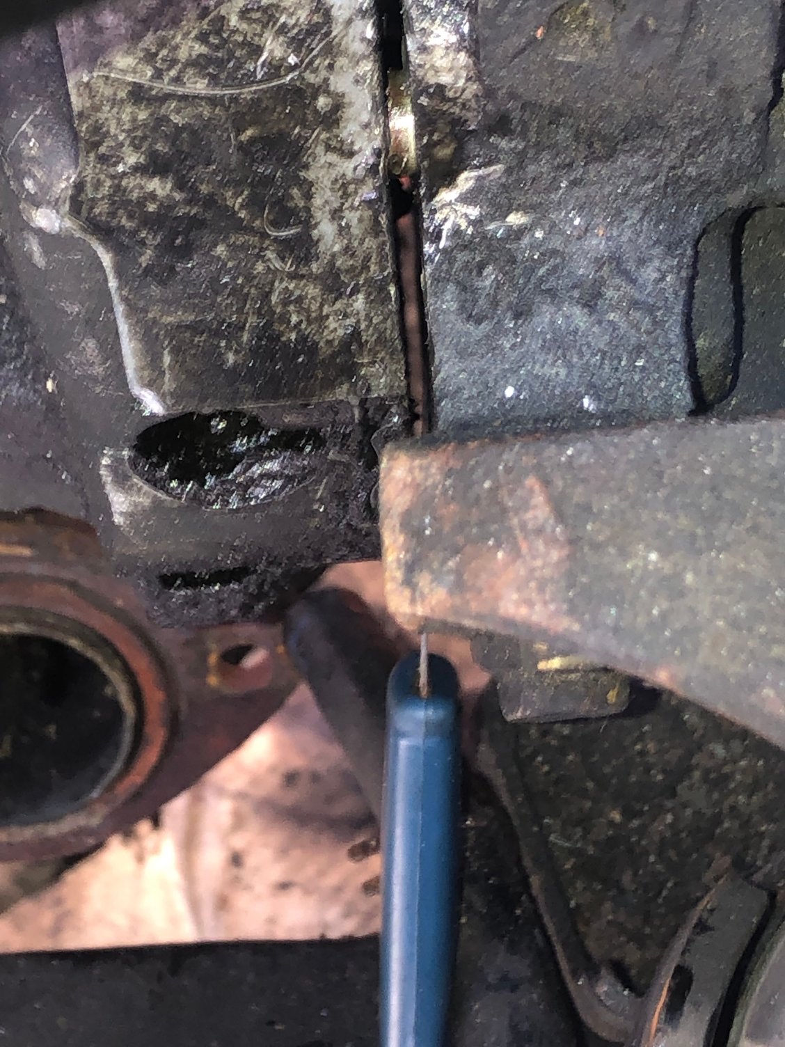

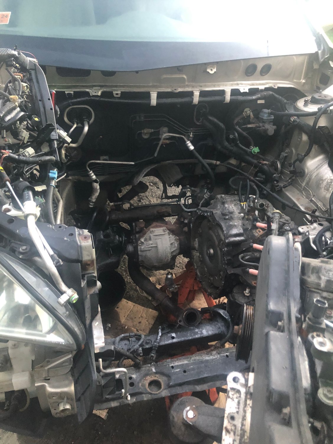

Separated the transmission today. Probably would have come off much easier if I realized the transfer case to engine bracket was still attached. But I finally got to it and then one pry and it was off. I had started to separate them and had worked about 7mm of space in the front and top seams. Then As soon as I took the bolts off the bracket she just needed one pry.
I was still struggling to pull the engine out the top with the back header still attached so I’ve decided to remove the front bumper fascia and bumper reinforcement bar which I did as well today. Just need to make a evacuation canister with on old propane canister and then tap some threads to fit in a 1/4” / 1:4” npt to flare fitting to evacuate the Freon and remove the condenser compressor and radiator. The radiator is already disconnected I just left it in because it seems to be attached to the condenser with 2 small brackets on the bottom.
but once I’ve cleared the path I am going to slide the sucker out and then be ready to get the replacment and do the seals gaskets and timing belt before sliding her in.

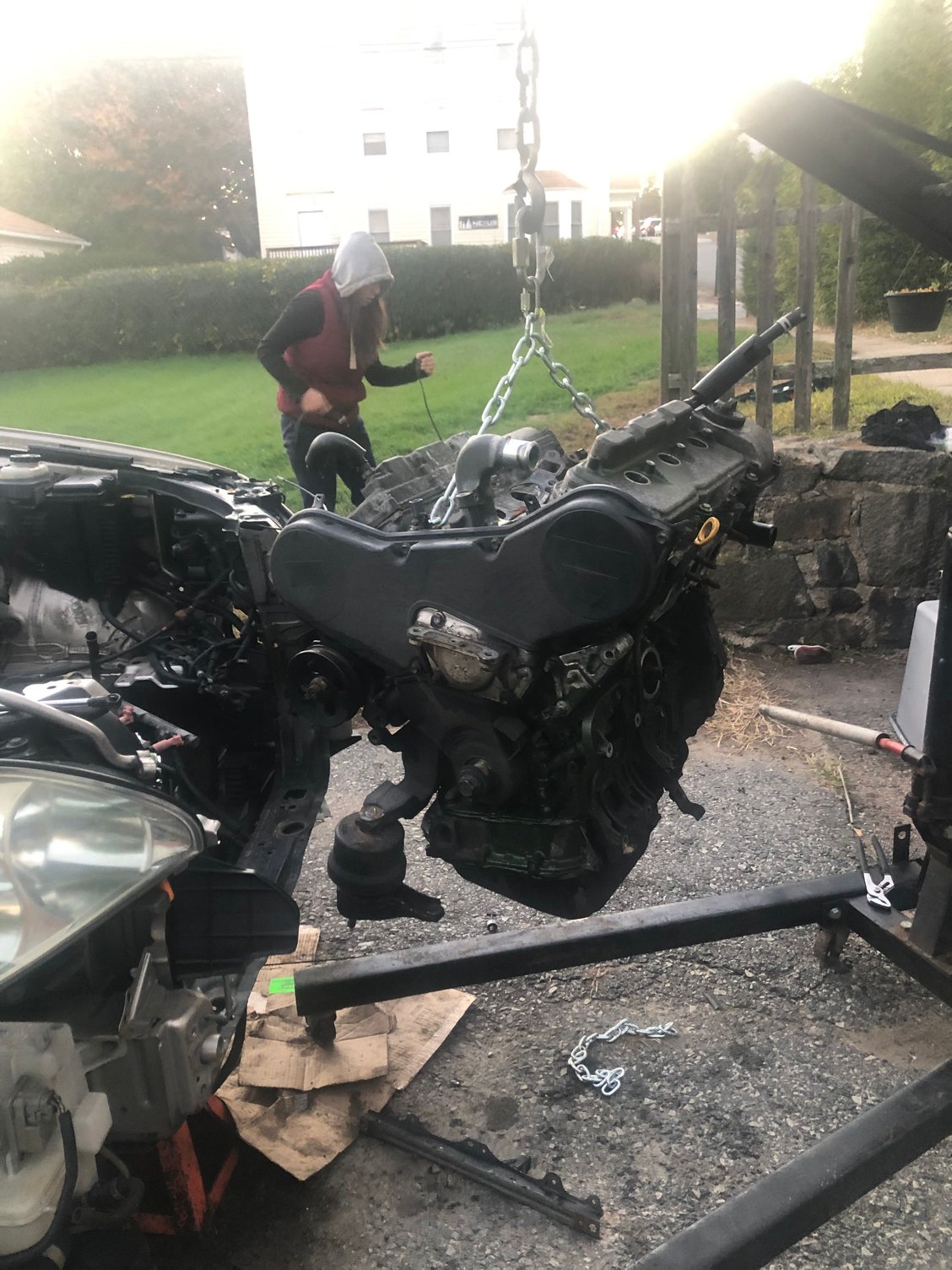

Default Reached the halfway point
Finally got the engine out. Need a new engine mount though I had to cut the threaded rods out to get it out easily wasn’t going to let a part I can get for 25 bucks at a salvage yard hood up progress
then I was trying to remove the ac lines from the condenser and the bolts sheared at the head. Had to drill one out and the mounting bracket broke so I have to find a way to fix that. Oh well most of the hard work is done. Now to get the new one do some work to it and fit it in. After I scrub the inside of the engine bay with some oven cleaner and brake clean
Nice job!
I was hoping for your success.
If you had to do it again wold you do it this way or jack the front way up and drop the cradle?
Also, just wondering if it will be harder going back in or you think pulling it was the hardest part?
Cheers!

Nice job!
Cheers!
pulling it was A *****. But I don’t think the worst is over. I still have to do the TB and gaskets/ seals on the new engine.
that being said I bought this one for 6k with 183k miles on it back in may. I talked them down about 1500 because there was no history of a tb service ever done.
the belt was very flimsy like a big rubber band and there were small micro fissures on the smooth service when I flexed the rubber tightly. But the water pump looked new and the cam seals were very hard and an orange color. Usually a bad cam seal will just deteriorate with pressure. That being said there was a lot of oil residue on the back timing cover on the back cam seal location mostly and a little on the front. So I really can’t say if the tb has never been done for sure but I’m leaning towards it. Maybe the cam seals are just held up and the water pump too. The belt was a genuine Toyota belt. It’s hard to say I’ll take pics later
I also saw the sad state of the crank sprocket. It was angled out about 3-6° so the crank is shot and that’s why it wouldn’t turn over by hand. Probably turned it over the last time when I turned the key to have a mechanic friend listen to it. Going to take as much off this engine as I can and bring the junk yard as little as possible if I do have to pay a core charge.
Now I’m going to have to get the transmissionmated to the engine. I’m going to do the rear transfer case seal and the seal
Where the output shaft connects to the drive shaft. Also have to drain the rear diff while I’m at it. Got 2 quarts of royal
purple 75w90
to answer your other question if I had to do it again I would still not lift it 3 feet in the air without a 2 post lift. Plus it would be easier the second time around since I know what to expect and what will/ can go wrong.
but if I had the space and $1000 I could buy a used 2 post lift off the internet right now. There is also someone selling a very high scissor lift that retails for like $13k for 1500. Man I wish I had money.
