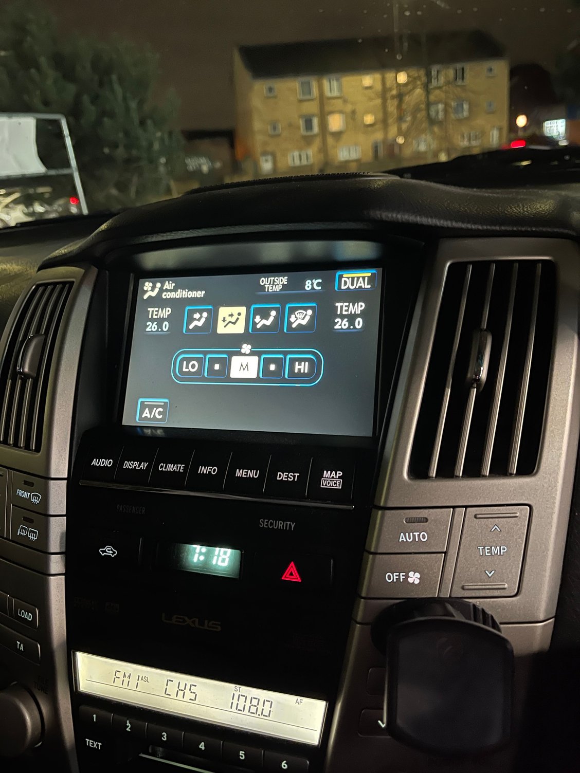

Now the engine warms up quicker and heating heats up quicker too but the passenger side heating is warm compared to drivers side which is hot. This wasn’t an issue before. Same with the rear vents, only warm.
I read the thread about the servo and don’t think it’s that as can’t hear any clicking. Could it’s be the heater core needs to be flushed? Or they nicked a hose or clip during the radiator replacement?

I have to set the passenger side to high for it reach the same temp as 26 degrees on drivers side. Weird.

Just need to sort out the passenger climate control and identify cause of the major condensation on windscreen.

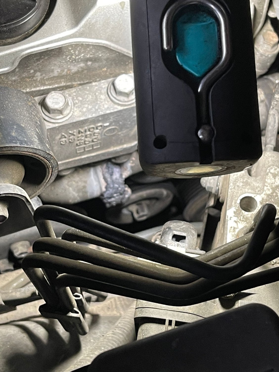

So this morning noticed a massive puddle on the road under the car. Took it back to mechanic who said that the pressure from the new coolant must have blown the water pump.
The water pump is leaking and has play in it. The metal water inlet pipe and housing block is also leaking and this appears so have been patched up previously.
Rang Lexus for parts:
water pump, thermostats (just to be safe), water pipe and housing. £430 inc vat. Not got a price for labour yet but don’t expect it to be less than £1000.
Tried 3 private garages, no mechanic will touch it.
Now im asking myself do I spend £1500 trying to repair it to keep or do I try cut my losses and sell for whatever I can get which won’t be much…

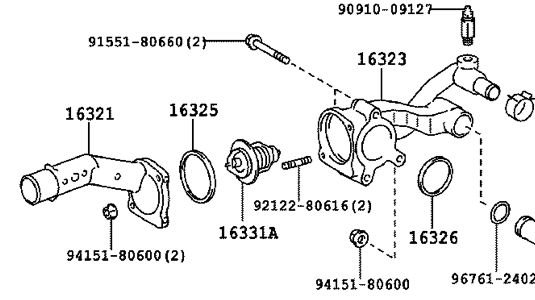

See this diagram
https://www.japan-parts.eu/lexus/eu/...water-outlet/2
See this diagram

See this diagram
See this diagram

Please see picture attached for the parts that are leaking in addition to water pump.
