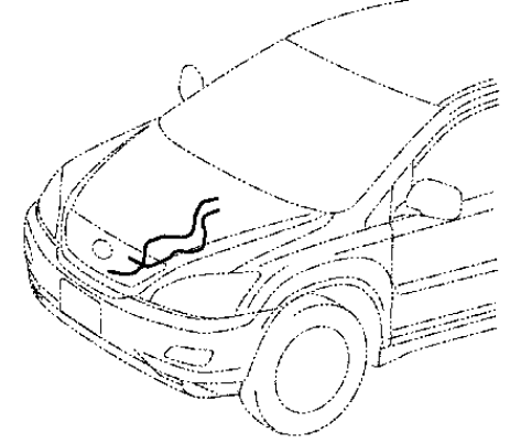

both hoses should be hot if the heater is on. there could be air in the heater radiator ("idle engine" can't push the coolant through)
PS: heater radiator hoses:
