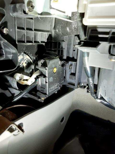

Hi Brucecav, this servo flap controls temp on that side.
Very easy- remove glove box first and then pull a black plastic downward vent tube off and out of the way(vent only held in with 2 claw clips).
Adjusting the temp up and down you will see the white linkage move up and down from this servo.
What you are seeing here is the all the way down position for max cold/no warm for the air mix.
I took this pic for another member, plz follow up and let us know how it goes and what you find.

Thank you!! Sobi just pull glovebox down, like when I change the in cabin filter ?? Or does it have to be totally removed?
I'll try this weekend. Thank you
