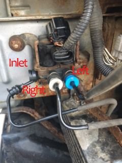

So where am I with this suspension?
I decided to have a look at the front suspension valve.
Accessing this is a bit of a job. DON'T follow Lexus's workshop manual to gain access. They tell you to remove the wing valance. (The bit round the wheel)
All you need to remove is the front bumper. To do this it's all popers and screws, with only one each side being difficult to get to. Easily once you pull the the plastic back slightly.
Where the screw attaches to the wing. You can see the plastic you need to pull back to get at the screw when the bumper is still on. My finger is on it.
So now all is revealed it's easy to gain access to where any air leak can hide.
This picture shows the front height valve with it's connections, which are possible leaks points.
A joint on the right side.
Another joint on the left side.
I hope this helps anyone looking for potential leak points.
Unfortunately for me, all this work didn't resolve my issue. I'm still searching for my leak.
