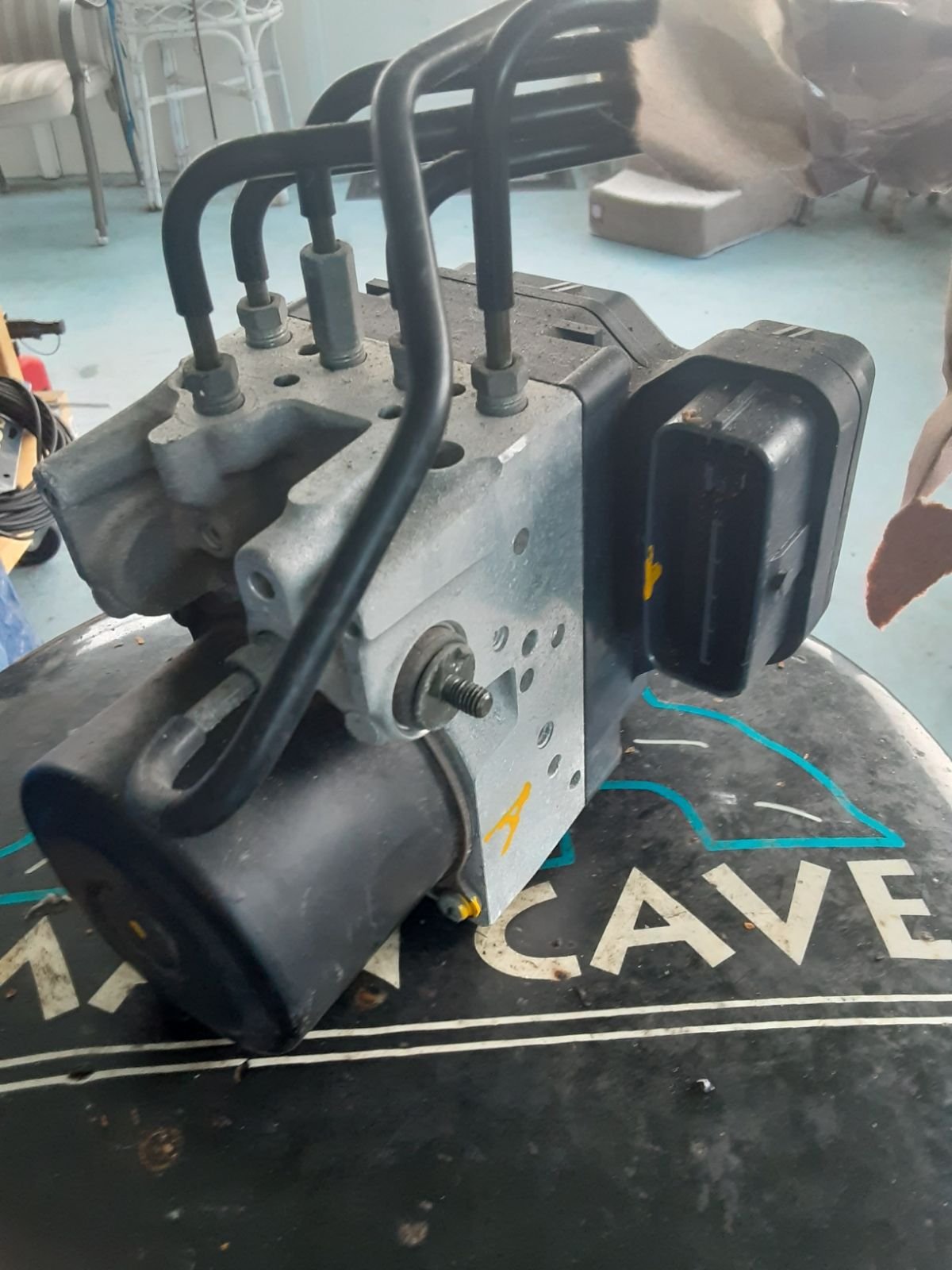

I don't know abot the hybrid but I heard on some cars the quacking sound can come from a failing motor that is bolted to the brake actuator.
I bought a couple of complete brake actuators for $80ea on ebay to keep for spares because I thought mine was failing.
My brake pedal was sinking to the floor and I had some trash clogging the tiny valves in the valve body but it was cleared out with a few brake fluid flushes.
If it is just the motor it may be easy to replace but I haven't verified this,
I'm just noticing the motor's mounting screws so it looks to be removable(look at the black cap in pic below appears to house a motor).
Of course like others mentioned it could be something different making the noise.
I would like to see a pic of your on the hybrid for comparison.
Here is a pic of my spares for 2004 RX330

Hi nooblex, can you see if you have an actuator as pic in above post?
If so can someone touch the black cap in the pic and see if the noise and vibration can be felt there when pressing the brake pedal and quacking?
I'm looking for a reason to remove the black cap and see if it is a motor that is replaceable or what's under there so if anyone wants to see let me know and I will take it apart and post some pics.
