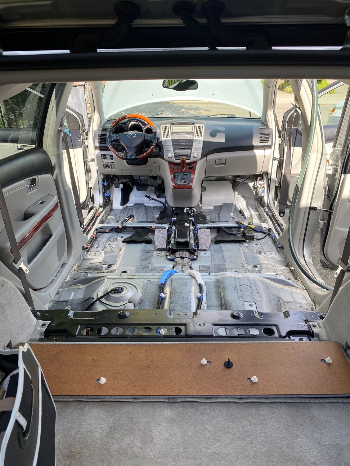

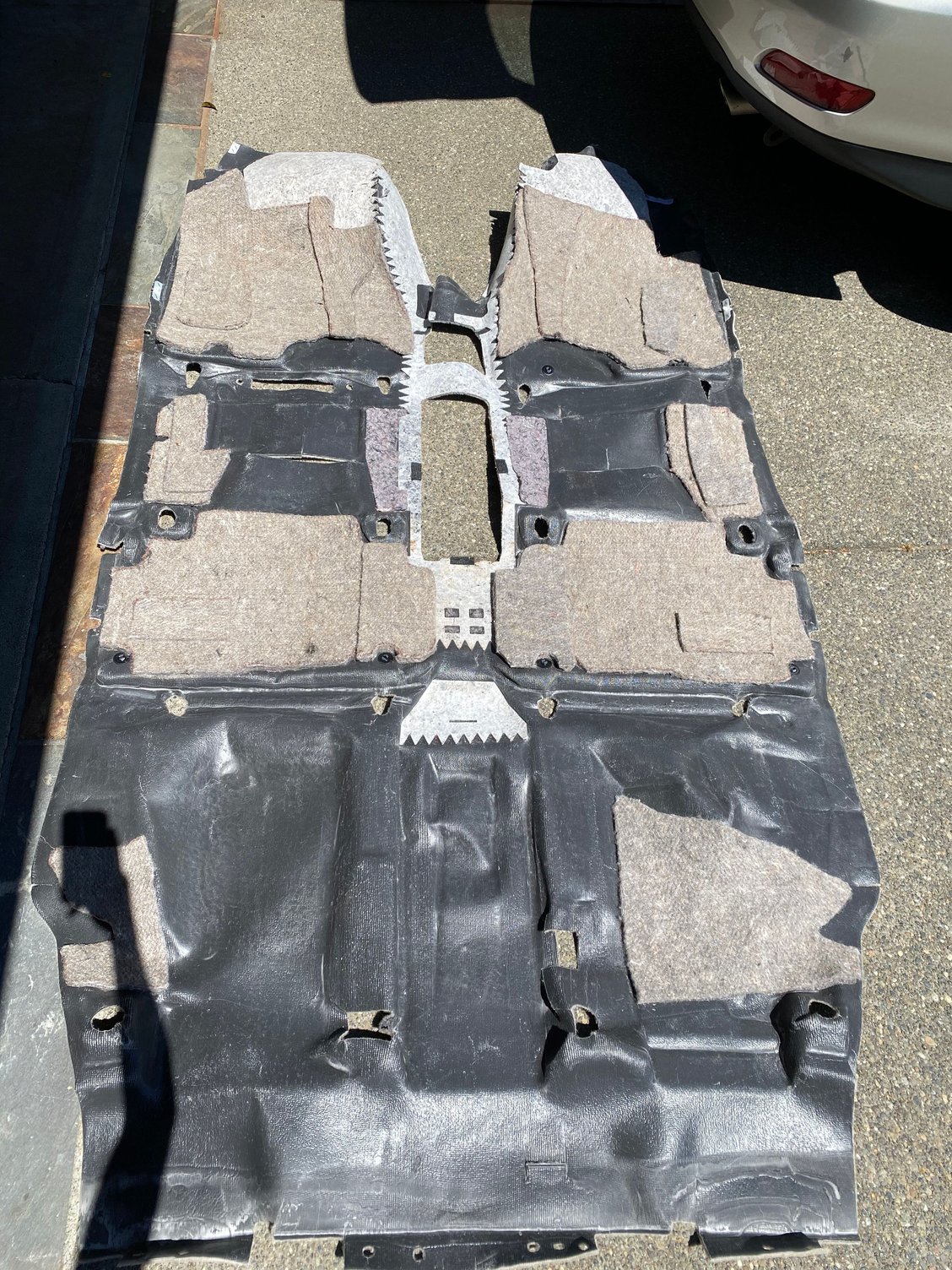

I have an 05 RX330 that I just bought, and didnt notice that it had a severe sunroof drain leak until i was about to do an interior detail. There was a small wet spot on the driver’s side floorboard where a body plug was pulled by the previous owner to try and remedy the solution. I pulled the carpet back and found that all 4 floorboards were wet, for god knows how long, as it sat on a dealer lot for 2 months, but the carpets weren’t wet because the padding and carpeting are separated by rubber. I am going to do my usual carpet extraction on the carpeting because it just has usual dirt and spillage on it, but i’m worried about the padding. I sucked all the water out of the padding with a shop vac and let it sit overnight outside with a large fan to dry it out pretty good, but how can i make sure there’s no mold or anything living in the padding? I dont want to put the carpet and interior back together and have stinky mold months later. It actually doesn’t smell bad now and i didn’t smell the musty moldy smell when it was still wet until i pulled all the carpet out. Should i follow the guides on the internet about cleaning home carpet padding? Any particular mixture or solution i should use? I assume i soak it with something and then shop vac it and let the rest dry for a few days, yes? Thanks in advance.

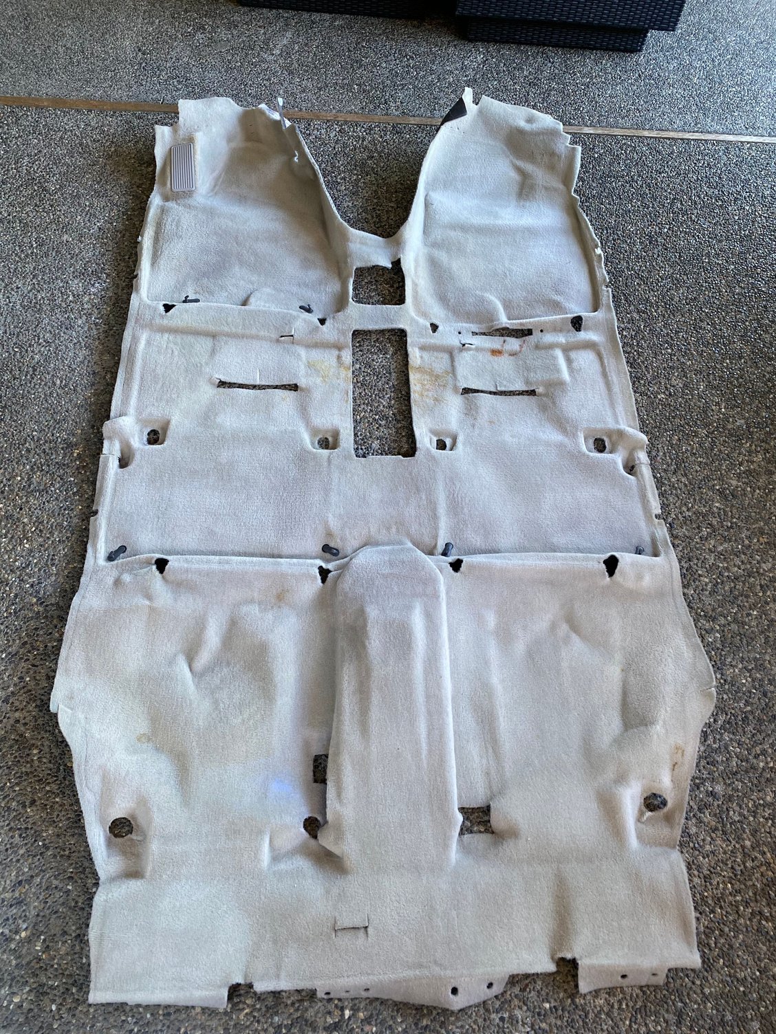

The padding is toast, I give up on that. I'm going to nuke the carpet clean since I actually know how to do that, and I'll probably buy some jute and glue it to the back of the carpet to replace the old crap. Really tired of this

Just in case it helps someone in the future... i recommend just getting rid of all the padding. It’s so dense that it’s almost impossible to rid of water and mildew. Wash the carpets real good, whether that means sending it to a cleaning service, using a carpet extractor, or pressure washer. Buy new automotive jute insulation (got mine from an automotive interior restoration shop) and cut the pieces out to match the old padding, including where it’s double-layered, and glue it all together with some 3M Super 77. I also Lysol’d the floorboards before reinstalling the carpet.
