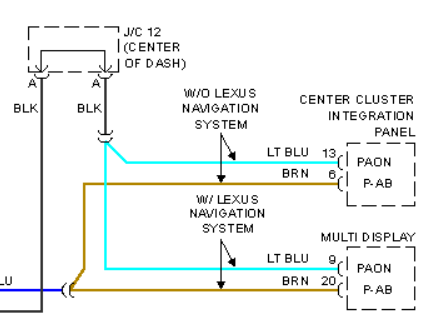

Lexuswiz above is correct, see link for info about P-AB wire- this is the cause of airbag light.
Still like to see your finished work pics and any info you can provide for install walkthru for anyone else following your work.
*Plz observe caution notes in thread and manual- this wire connects directly to the Air Bag Center Assembly ECU!
Link: https://www.clublexus.com/forums/rx-...o-non-nav.html
For anyone doing an android upgrade there are 3 different wiring schemes(maybe more) for the air bag wires. Above link is for 2004 and uses only 1 wire(P-AB)
In 2005+ air bags have 2 wires(PAON & P-AB) as seen here- "Multidisplay" is Navigation and "Center Cluster" is Non-Nav version.
Somewhere around 2007-2008 wire colors changed again.
In 2008 air bags also have 2 wires(PAON & P-AB) as seen here but wire colors changed- "Multidisplay" is Navigation and "Center Cluster" is Non-Nav version.

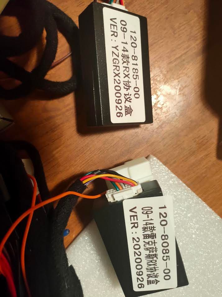

i think this also might be the problem .I have 2 sets of cables.Might of used the wrong ones
