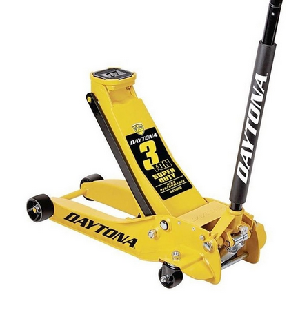

A while ago I invested in this DJ3000 jack from Harbor Freight and it's a beast and I really like it- and the handle serves well for a breaker bar extender too. lol
Also, I never work under any hydraulic jack because it is never safe- I only use it to lift the car up onto the jack stands.
I use 2 jack stands for one wheel and 4 jack stands if lifting 2 wheels.
how much was something like this?

I think it was around $179 at the time I got it approx 3 years ago if I remember right.
It will lift up both back wheels at one time no problem and just doing one wheel it lifts easy- it's heavy built tough ****. lol
As well as heavy to lift & haul around if you have to....
yea but if it can lift the vehicle up a ways and is heavy duty enough to get the job done then it sounds like it could be worth it.
