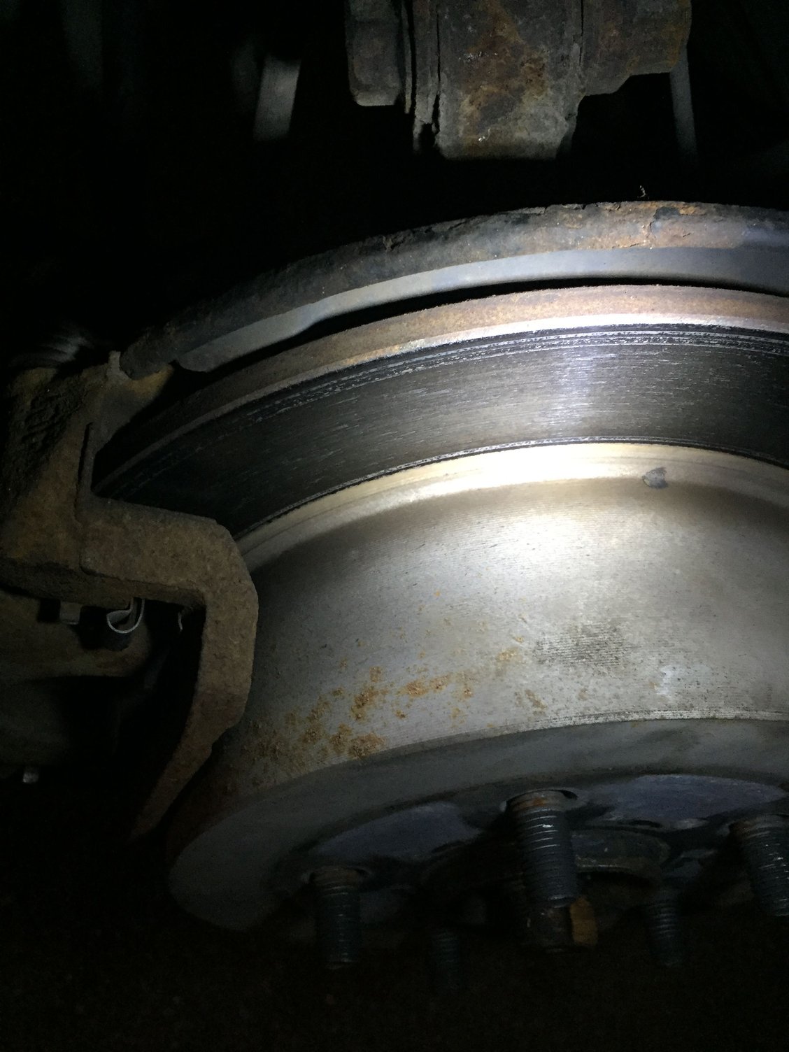

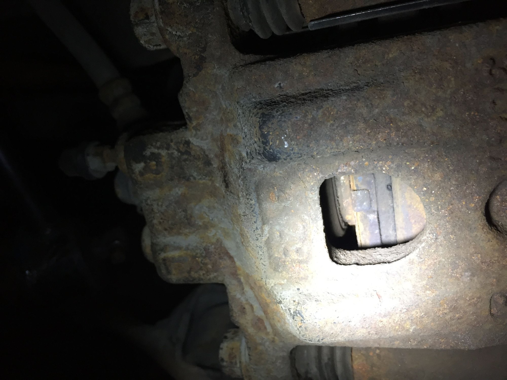

Here are some pics of the rotor and pads...

Wow, pretty rusty.........Looking at that rotor surface, w/ all that glaze....I'd lightly scuff the surfaces at least.
Old Jul 7, 2020 | 06:42 AM
fabchef's Avatar
fabchef
Joined: Nov 2017
Posts: 489
Likes: 30
From: Montreal, QC
Felix, our winters are harsh (salty roads). Think it's worth changing?
