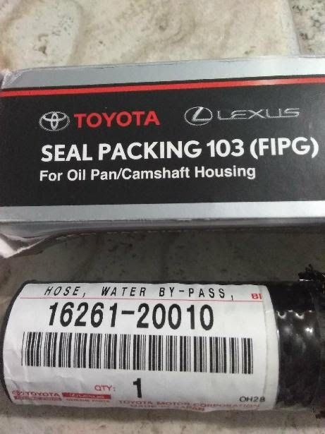

HI,
I will be fixing a coolant valley leak soon and plan on changing my knock sensors too while I am in there. Recommend knock sensor wiring harness(cheap on ebay)- known failure point and maybe replacing coolant bypass hose if you pull the intake manifold- at least that's what I'm doing while I have it apart.
While you are in there and you see a lot of red crusty stuff you may have an old coolant leak from where the top radiator hose connects to the water outlet over the manifold and dripped down or you could have a coolant valley plate leak. you will know when you get in there and have it apart if you have a problem or not. lol
I have to pull my intake manifold to get to the coolant valley plate where it is leaking.
This is the parts I bought showing coolan bypass hose and gasket material for coolant valley plate.
There is no gasket for the coolant plate so it needs to be made with OEM Toyota seal packing(there is a good video on youtube on the and replacing knock sensor and fixing this leak).
My car is 2004 RX330 FWD NAP 148k miles.
