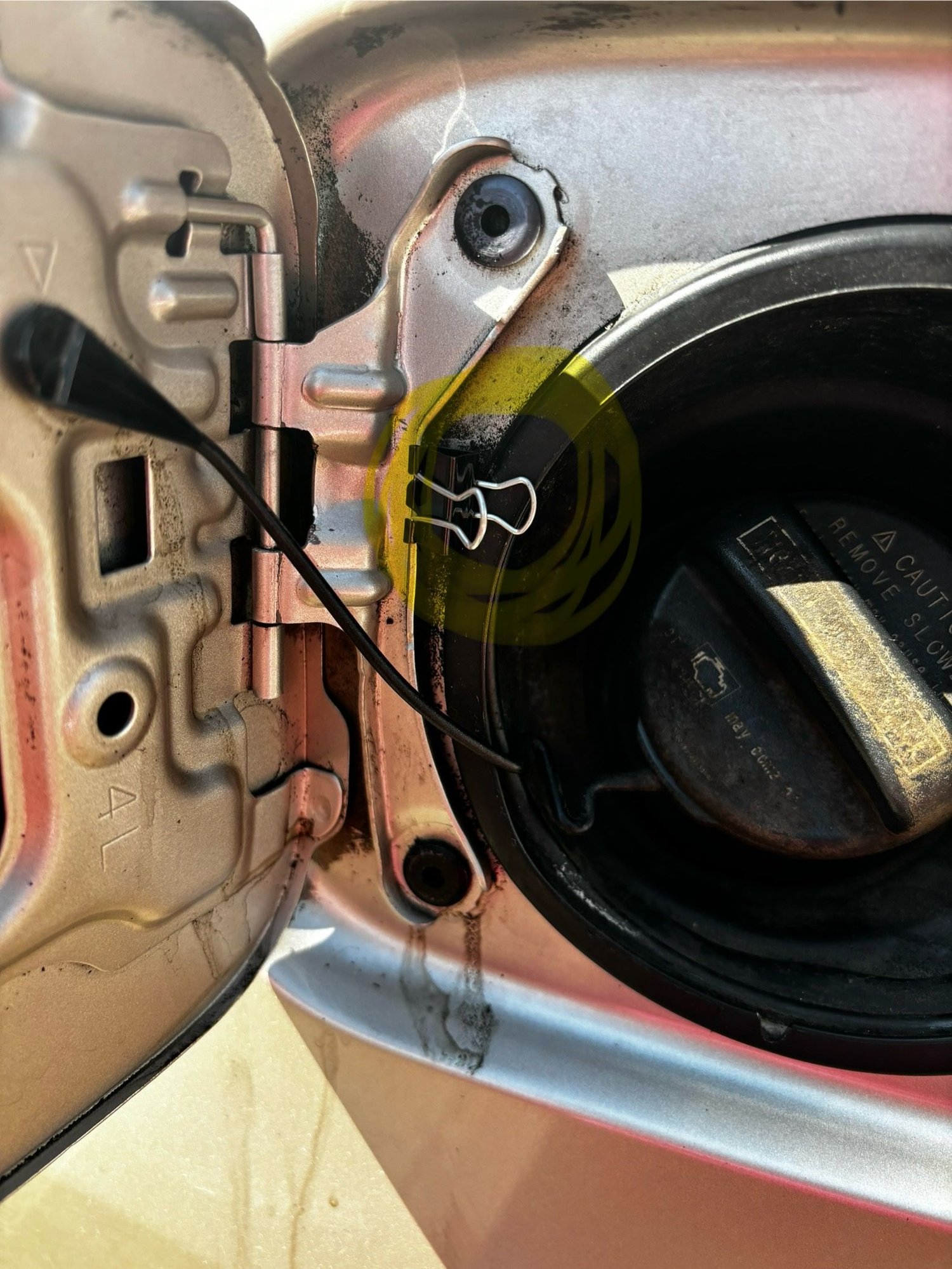

Just came up with a great hack if your gas hatch won't open due to broken clip. See small (smallest size) binder clip in photo. Works Great!

Thats Genius!

OP, you can fix that by removing the hinge pin (the bent wire), meausuring it, then simply getting a new piece as neither the hinge nor door look damaged. Using calipers you should be able to find that hardened steel wire at a good hobby store or possibly spme Michael's stores they usually come in 3' lengths made by a company called "K&S tubing"... Amazon may also carry them. For the top to hold it in place there are "wheel collars" made by Dubro you could use instead of trying to bend that thicker wire as shown... total cost would be under $10. It is also possible that a simple nail could work if the diameter was close enough
