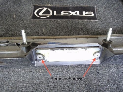

Is there any way to get @defo 's original 2013 post with the pics showing? I've refreshed and still no pics. I have the part and need to do this. The link in the sticky just goes here.
There is a guy on Youtube who shows you how to just pull the switch out, 2 screws from the outside, and then unplug it from the cable. I am tempted to go that route since I am thinking how often is the cable the problem anyway?! My switch mostly works but not when it gets cold and of course all the rubber/plastic molding is gone. I may go that route, any thoughts? I could keep the cable and do it later if needed.

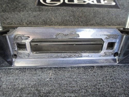

READERS, EVERYONE - If you have never done this, I recommend doing it now before it gets worse. The link and pictures above are the easy part. The mess, oh the mess....that melted rubber gets all over everything. Ever little black speck will smear and require treatment. Every tool you use will be back coated and will require scrubbing with Acetone, paint thinner, or like me go with Dawn dish soap and alcohol. Your hands will be black. Mine had melted into the washers and the screw thread so they had to be soaked and scrubbed. Such a mess. If you go out there ready, I am sure it is more manageable, but I went out there for a 20-minute job....and HOURS later it was done. Be warned.
