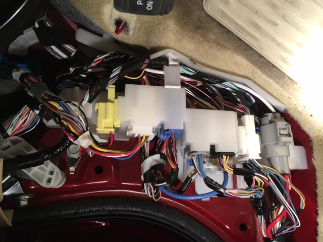

Default Wiring CF on 2011 RX450h
... ahhh, where's that hole?
It's raining out here... and inside the foot well too!
