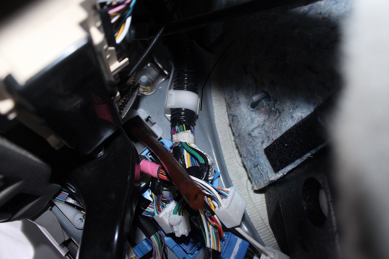

Sunroof / Moonroof Leak-sunroof-tube.jpg
Sorry this pic is sideways but you can see the brown tube is not long enough. Here is why these leak. This tube needs to be extended. We chose to go right behind the wheel well liner

Pretty much exactly what they did with my last RX. Extended the tube to go outside the car to avoid it filling and spilling into the cabin. Any idea if this is a DIY thing at home?

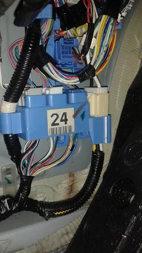

Here is a picture of on the driver side (US) not sure where the hose will be?
Attached Thumbnails Sunroof / Moonroof Leak-unnamed-1-.jpg

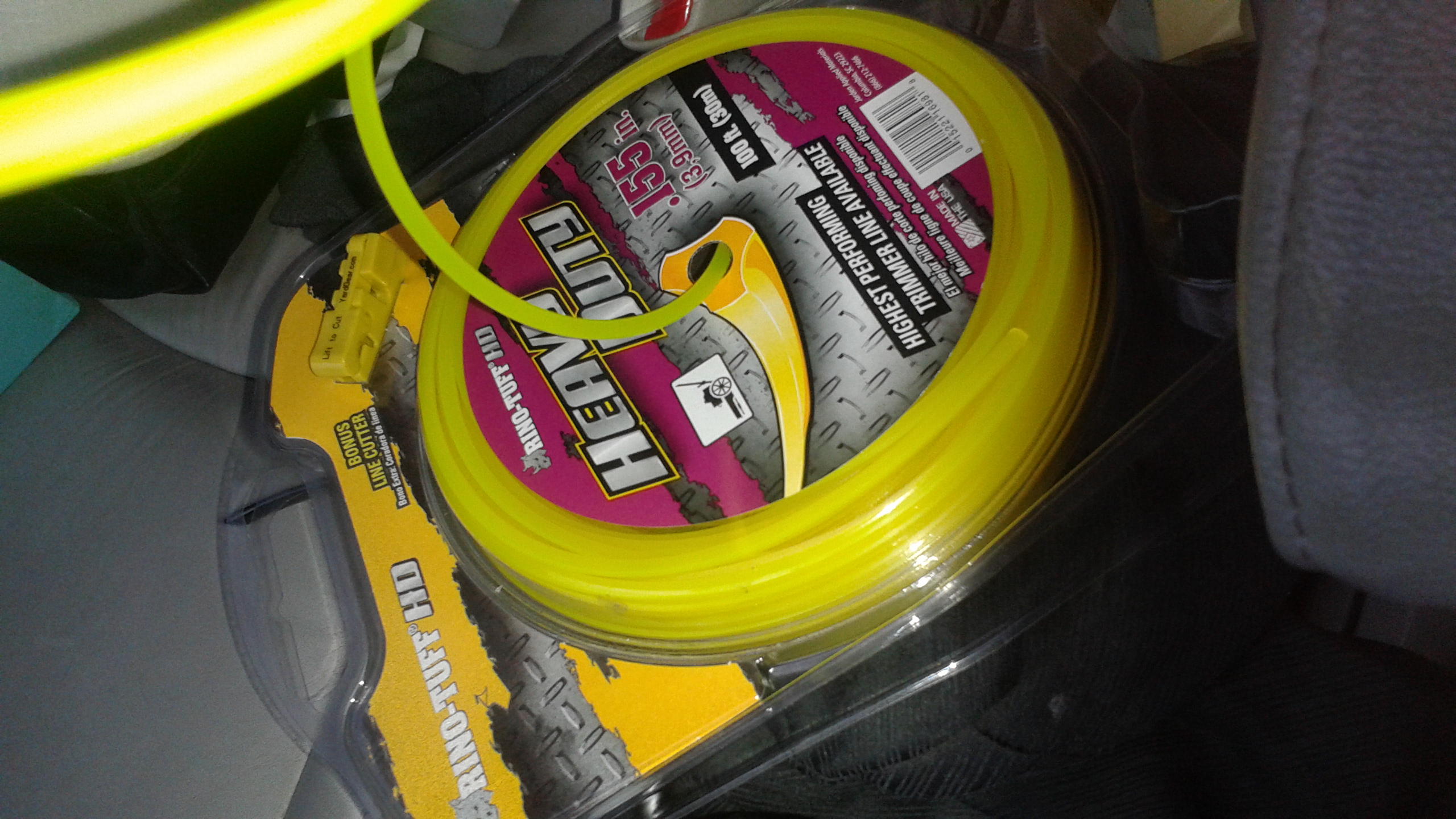

I attempted to use weed wacker plastic wire. I suggest getting a thick gauge as in picture.
I ran the wire all the way through but there was no clog
You can see the yellow weed wacker wire all the way through.
I then pulled the blue box which had all the wires on it.
Behind the box I found the sunroof drain tube
But the tube seems to be just sitting back there.
Is it suppose to be connected to something?
Planning on extending it.
Where do I extend it too?
Had a downpour with the sunroof closed and it filled about half a water bottle. So as stated elsewhere these sunroofs are not made to be water tight. These hoses should be maintained regularly.

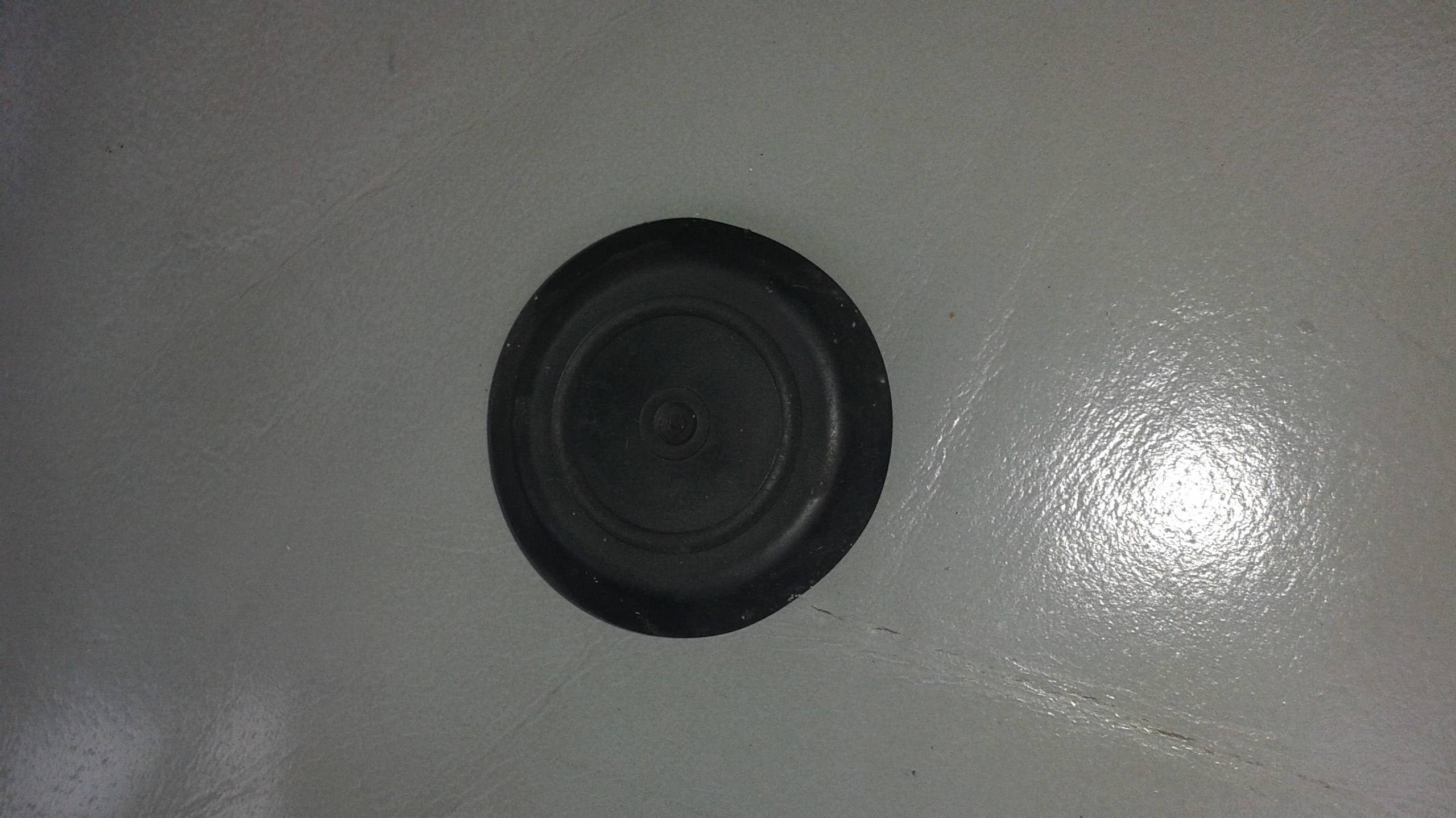

Draco is this the hole they used to run the extension?
Attached Thumbnails Sunroof / Moonroof Leak-20150830_102521.jpg   Sunroof / Moonroof Leak-20150830_102555.jpg   Sunroof / Moonroof Leak-20150830_102638.jpg

I think i am officially stuck though
The body plug that I pictured earlier was a dead end. It looks like its going into the frame itself, not into the car nor into the area where the original drain tube is.
From what I understand looking at the picture attached, the water leaks into that area (colored in red) and then eventually trickles down and out near the mudflap area onto the floor outside.
There are no other body plugs in that area to extend the drain tubes into. Unless I drill a new hole?
