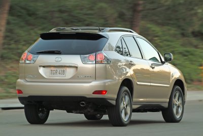

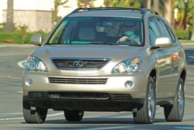

i figured i might as well wait til mid september and pick up an '05 RX 330 AWD( i originally was in the market for a '04). my question is, what are all the changes in the 05's? and do they look as the same as this(found the pics in the top thread)?:

AFS stands for Adaptive Front Lighting System. (No idea why it's not AFLS...)
It allows the headlights to turn left or right if you're steering left or right. Cool thing for a curve in the road or a turn. I believe they'll turn as much as 5% to the left and 15% to the right.
If that was available separate from the performance package and part of a standard build for my region, I certainly would have gotten it.
