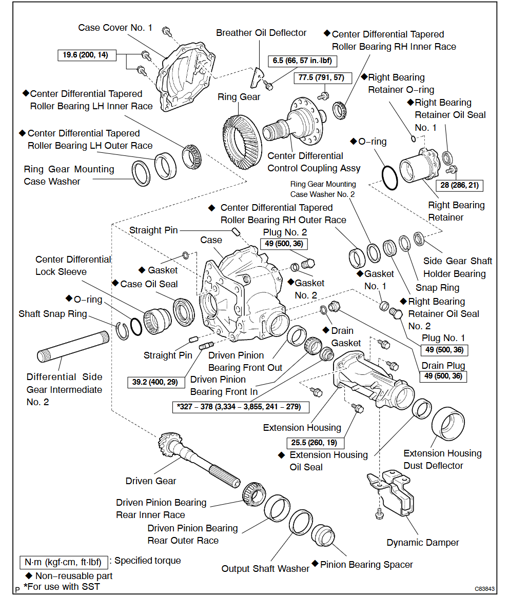

The tail section of the t-case does contain fluid. It has an oil seal and oil will pour out like crazy if you remove the driveshaft yoke from it. I had my car about 2" off the ground like you when I filled my t-case and I put in about 1l of 75W90 GL-5 (Redline NS). Both my 2002 Highlander (Mobil 1 75W90) and 2008 RX350 both have the same transfer case, and in both cases the cars were not level, but fluid still poured out the top when I pulled the fill plug first before pulling the drains. No whining after. These t-cases are super tough and they'll basically run on tar! My RX had like 0.4l of burned nasty oil in it when I drained it!

Thanks for the reference on lifted front end tilted fluid change and the diagram. Very helpful. I'll try to get an audio in a few days when I see the car next and follow up. Maybe I'll pump in the remaining 0.1L to start... can't imagine making any difference. Followed by switching to Pennzoil 80w-90 GL5. My impression (could be wrong) is the fluid that came out looked clean and was thicker than the 75W-90 synth GL5 that went in (Supertech viscosity felt similar to the valvoline synth I pumped into the rear diff). No longer have original fluids to compare
