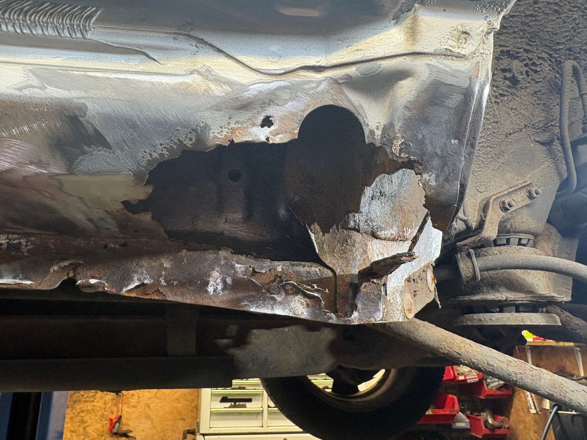

Anybody know a good auto welder Kent, UK? Classic nearside rear sill rot. Need to cut out and weld in a form panel to pass my MOT
From the wheel arch over the nearside rear sill

That rust looks far worse than simply replacing a section for appearance sake to try and pass MOT. These cars are excellent with the exception of being terrible in salted areas (Lexus and Toyota have very well known issues with rust).
Good luck... for safety reasons I'd be extremely cautious driving in that car going forward as the frame looks comprimized, what you see is not as bad as what you don't...

Yes – this is something that warrants careful handling. The offside is clean. The nearside gets all the kerbside debris and much of it catches under the plastic rocker cover – especially at the rear. The pinch weld is very solid still – but the corrosion hole is scary. I have found a professional welder who has manifold experience with Toyotas and Lexi. And you are right – they have a reputation for corrosion. The welder will use a specific steel for MOT level pass (he also runs an MOT centre). Anyhow, I want to keep the old girl going. I have made the mistake of having some affection for her!! She has served me well.

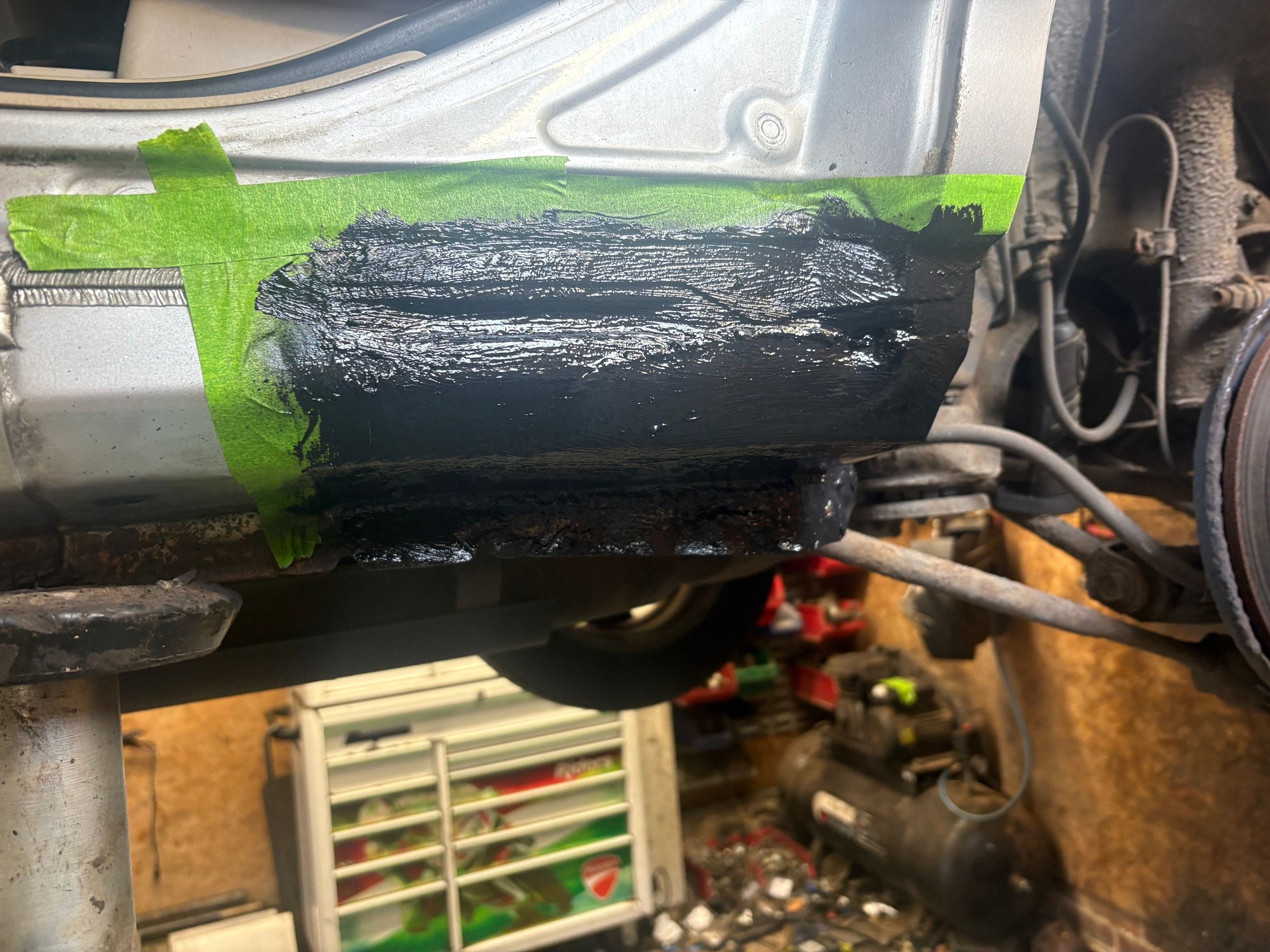

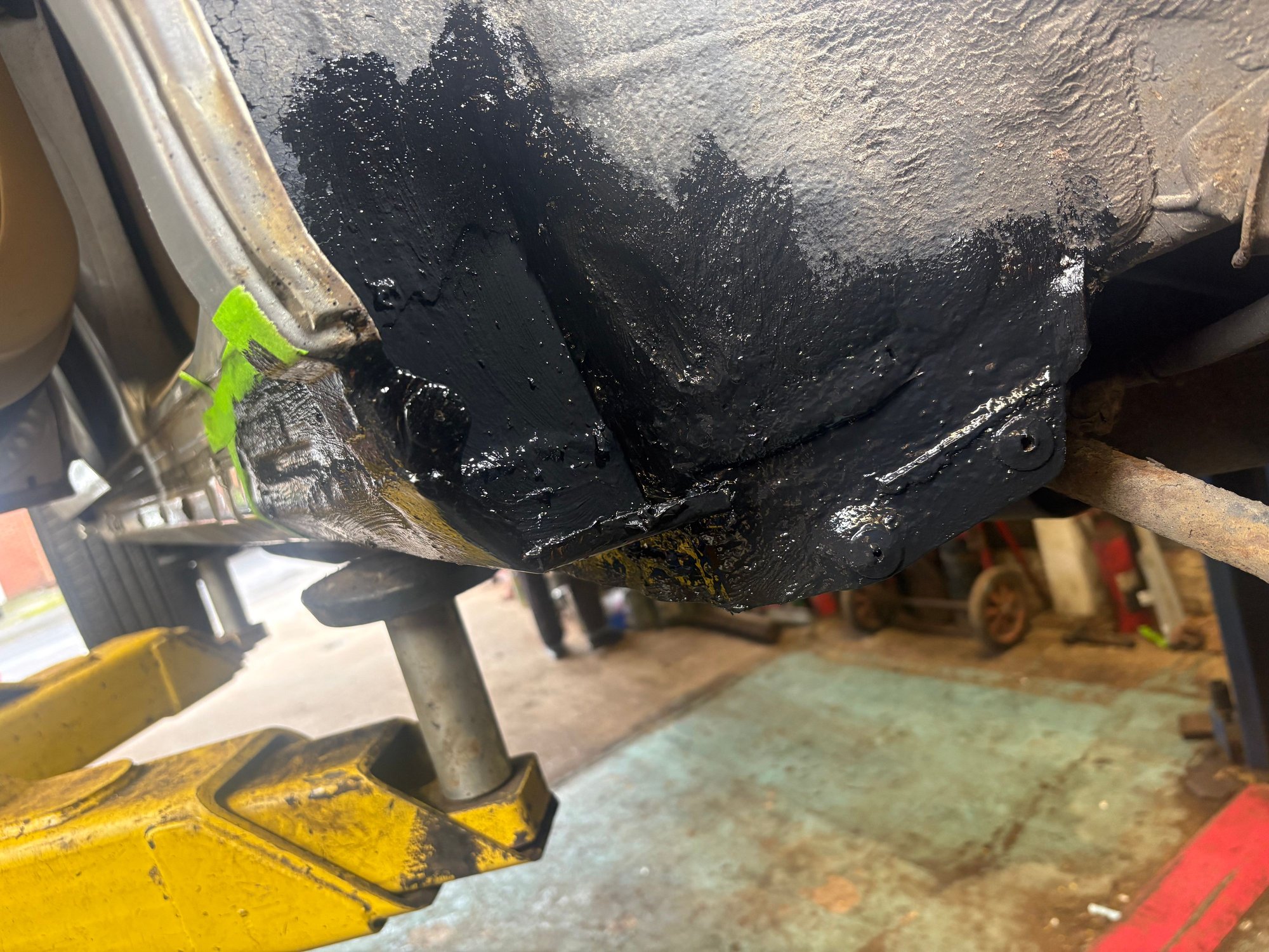

Just scraped through the MOT. The inner sills are still an advisory and a new major advisory is rear sub frame corrosion (MOT man: "A very close call, you just scraped through")
The rear sill hole was welded – and the shop putty plugged an exhaust hole, though that was mentioned still as a minor leak advisory – vehicle sounds more like a V8 now. Shop bitumened various sill areas (clearly I need to do more work). "You've got 2 years if you get underside and do a major wire brush job and reseal. But the sub frame is at risk". Bloomin' cars. Suppose at 21 years on the road its had a good innings
The hole
The hole
Repair
Repair
Repair
Repair

It isn't the rust you see that is the problem nor can you get at the rust that matters. You can patch the exterior all you want it won't stop or delay interior rusting within the frame rails and other structurally important ares... it may be good eough to fool MOT. Lexus/Toyota of these years were extremely suspetible to dangerous rusting like seen here, actually so were most early Ferrari's but that is another story.

Yes, it's that old chestnut the rear sub frame. "I reckon I could have found rust spots to push the screwdriver through" said the MOT tester to me. Hmmm well I'll get under and see about that. But it is a classic area of corrosion as are the sills. But latter is easier to fix than the former.
