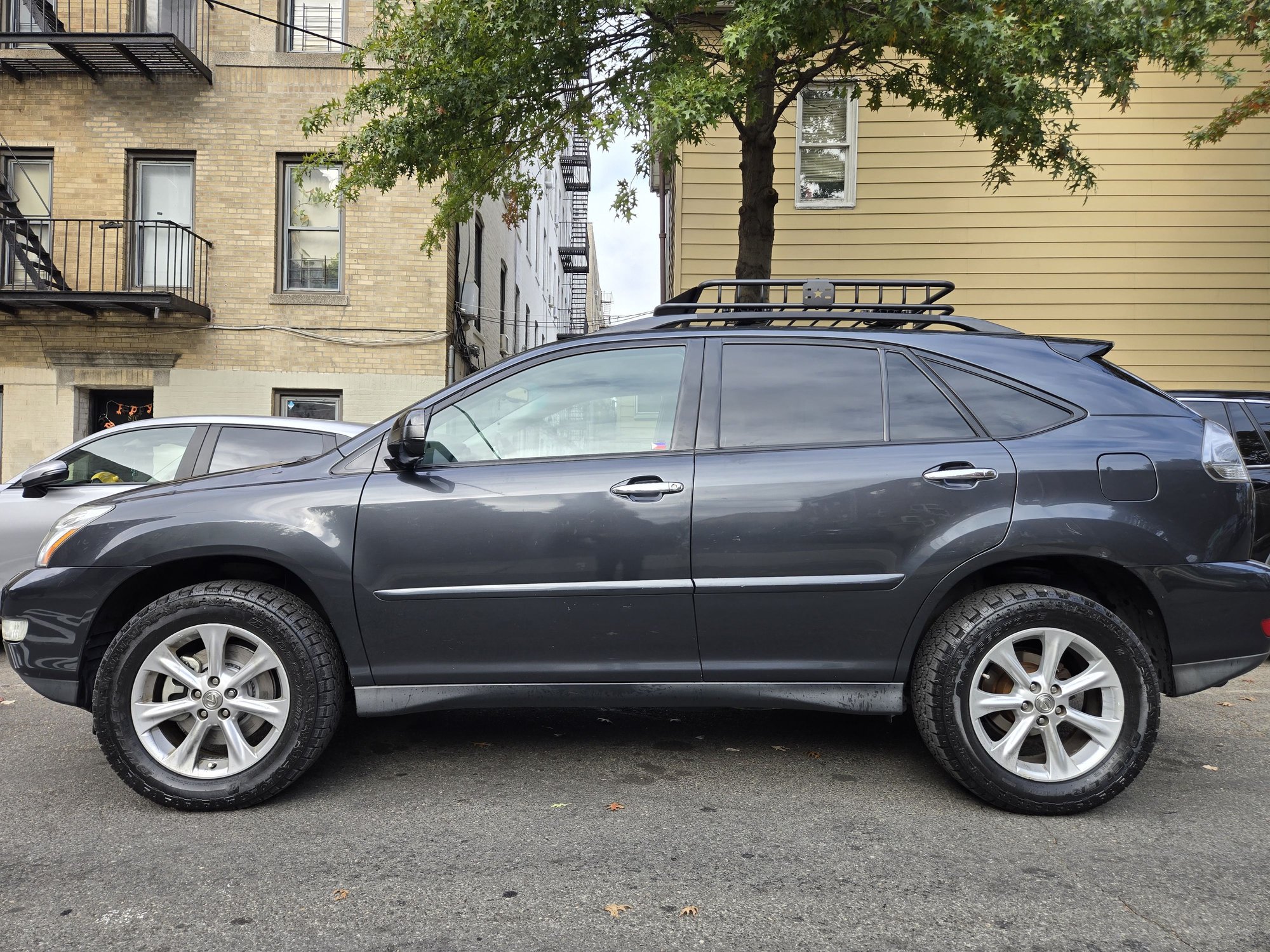

Just sharing to finish off this thread. I finally pulled the trigger on bigger tires!
This is me jumping in the Badlands, Wilderness, Trailsport, Trailhawk trend.
I got 245/60 r18 Bridgestone Dueler A/T Ascent and it looks great!
On stock wheels, no spacers in front. I needed spacers at the back, I had 20mm because the tire shop insisted but I believe you can do with less spacer. Its the design on the tires sidewall that is causing the issue.
I also did the recommended BKK and SS lines. Oh boy I had to argue with the mechanics and show them the brakes fit! Anyway, its all finished now.

Looks great, ''Manong sauce''.......If your wanting to do a rear BBK, you'll want to go w/ the 2nd gen Highlander setup, '08-'13. You'll find the 3rd gen rx calipers bolt but will be offset to the disc & the parking brake hat is a bigger diameter, meaning a complete 3rd gen backing plate, parking shoes, ect, wheres the 2nd gen Highlander uses the smaller parking brake hat & has the bigger disc diameter as the 3rd gen rx. End result= Go w/ the complete 2nd gen Highlander brakes= rotors/pads & a pr of reman calipers.......Not quite as noticable as the front brake upgrade, but you''ll find the rotor diameter is bigger & the brake pads are about 1/3rd longer. So if your needing rear brakes, you'll be out a pr of reman calipers. Flush the old fluid out w/ nnew dot 3 & great time to replace the brake hoses w/ new rubber ones, if not SS hoses.........
