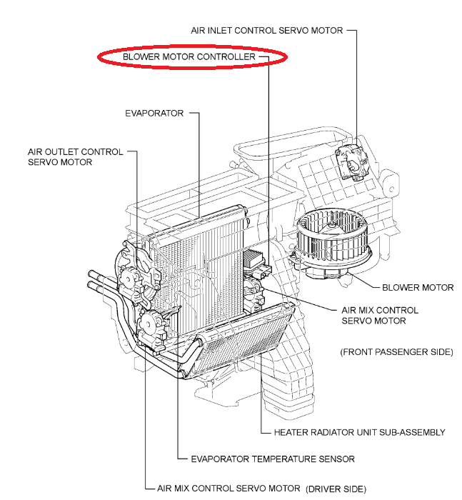

Yes, not just on 2008 RX350 but on every vehicle, and a simple explanation is :
Blower motor resistor = blower motor controller = control blower motor speeds using the signal from A/C amplifier
Blower motor control module = A/C amplifier = A/C ECU = control the entire heating and air conditioning (compressor clutch, idle speed. ect.)

Some have called blower motor resistor as blower motor control module!

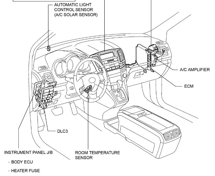

Where is the AC Amplifier = Blower Motor Control Module located? Can that go bad resulting in less air movement? What would be its Part Number?
So many great posts above.
Don't quote me but I think the AC Amplifier aka module is a small black box located under the glove compartment.
Pull the plastic stuff out of the way and remove the glove box and shine a flashlight straight up at the front edge under the dash closest to you.

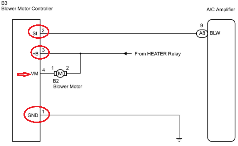

Can the A/C amplifier that go bad resulting in less air movement?
Yes but less likely.
Don't just replace parts, you will need to test the blower motor controller, A/C amplifier, circuit between the two units (SI - BLW). Test terminal 1 (GND), terminal 3 (B+), terminal 2 (SI) and terminal 4 (VM) of the blower motor resistor. Best of luck!
A/C Amplifier = 88650-0E021
Blower Motor Controller = 8716513010

Originally Posted by tammap
I like this pic.
OP can check the voltage at the blower motor.
Just probe the blower motor plug and see the voltage when the fan speed is turned up or down and let us know what you find.
