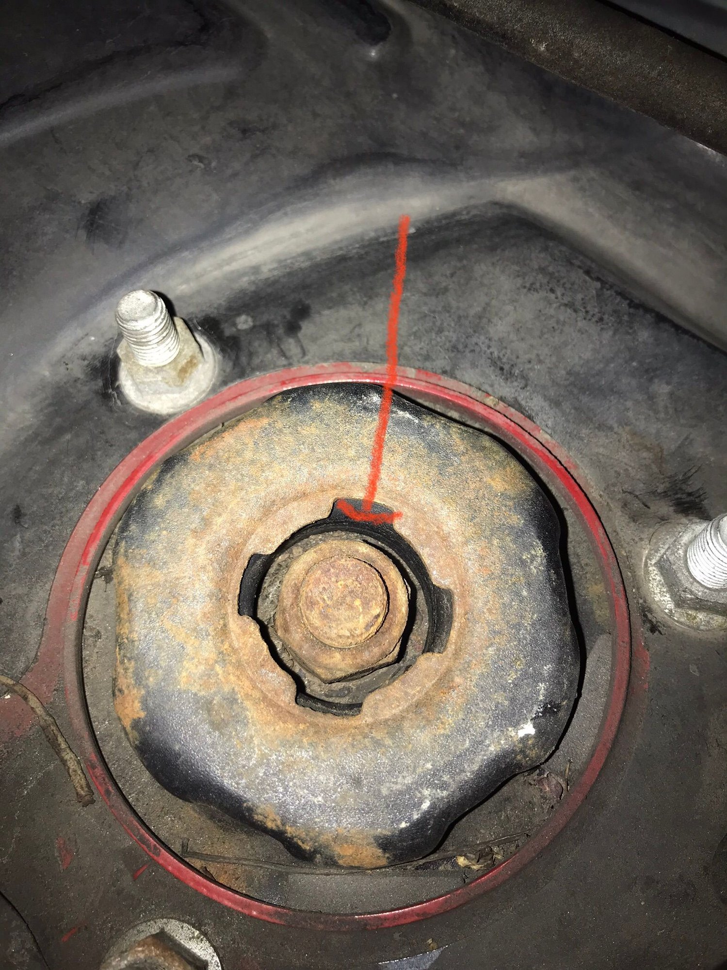

Sounds like ball joint or shock mount... try spraying oil on shock mount (top of strut) thatis easy and pretty much free

Leeper... never heard of putting oil on top of the mount. What kind of oil do you use? Where do you put it, and how much to put? Do you put it where the red arrow is? See pic..
thanks
fab

Front shock mount has a bearing exactly where your red arrow is perhaps shooting some silicone oil there could help quiet it down if it's worn. If you find that quites it down probably time to replace it. Judging by how rusted it looks I'd venture to say it's likely shot... you live in a salted road region? Silicone spray also helps keep rubber bits lubed and protected

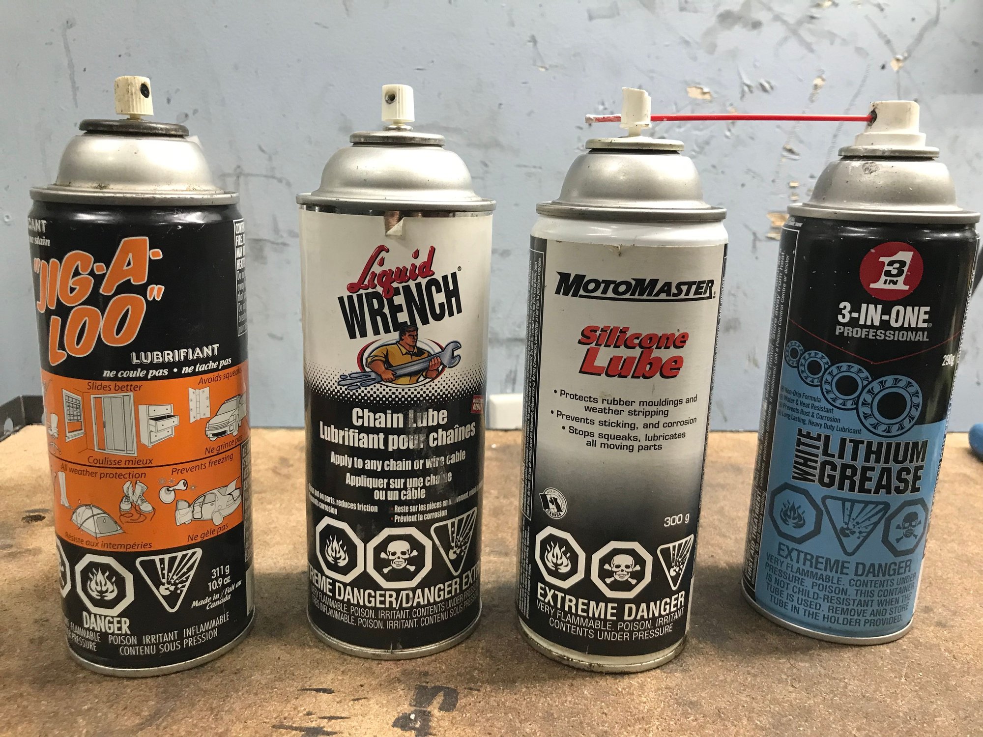

Leeper... first off i wanted to say thanks. I had sprayed the white lithium grease on the one side, upper mount that was making noise. I went for a super-tiny drive and seemed quiet. I then sprayed more on the same area and i also did the right, front mount too and let everything sit for a few hours.
i just got back from a short drive and all is super quiet and smooth again! I think the rubber part had just gotten a tad dry and was cusing some friction (rubber-bounce), and needed a lube?
should i just keep the white grease i put, or wipe it off and spray with silicon oil spray? Here's a pic of what i have. I also have (in liquid form) wd-40 bicycle chain oil (not in the pic though).

Awesome glad to hear! Of those choices I'd go with the silicone spray it's best for rubber. This is so likely a temporary fix as the problem is still likely the bearing in the shock mount itself.
WD-40 was designed for NASA as "water displacement" not as a lube. Chain lube is usually good stuff, white lithium grease would be awesome if you were repacking the bearing but this is not disassembling anything just shooting it from outside go with silicone then think about replacing the bearing when you can.

Leeper.. so you're saying to use the motomaster one? I used the blue "3 in 1" can.
I guess i should wipe off the stuff i put on, before applying the new one?
i also forgot to mention, the struts are not the original ones...i had swapped all 4 corners a few years ago with FCS quick struts.
