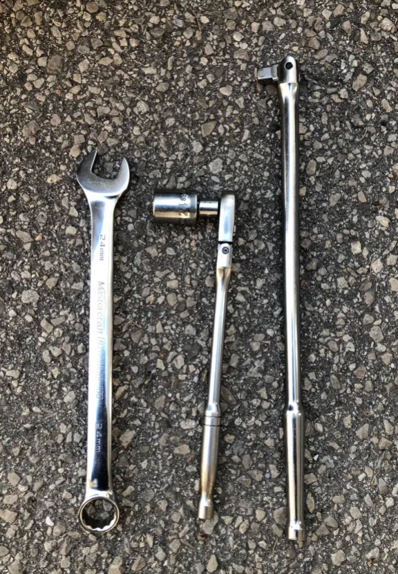

It seems hard to find the post about it so I'm going to post it here:
Tools: 24mm wrench, 3/8" flex head ratchet w/ 3/8" to 1/2" adapter w/ 1/2" 24mm socket and 18" 1/2" breaker bar
The t-case takes 1L (1 jug) of 85W-90 GL5 gear oil from the factory. I just used synthetic 75W-90 on mine as 85-90 is harder to find. You will need a pump to pump the oil into the t-case. Fill until it starts pouring out.
I used the breaker bar to get the fill plug loose first, you won't have a lot of room w/ the exhaust pipe in the way so a compact breaker bar like this will fit, a ratchet will not as it's too bulky. The 24mm closed end side is used to break open the drain plug. Make sure to apply a lot of pressure and hold down so it doesn't strip or fall off. When refilling, the 3/8" ratchet comes in handy to tighten the fill plug back in as it is very tight. I used the wrench again to get the drain plug tight. The plugs are torqued to 36 ft lbs and you need two drain plug washers to replace them. I have done this on 3 separate RX350s (my 08 and two 07s) and it has worked flawlessly each time.

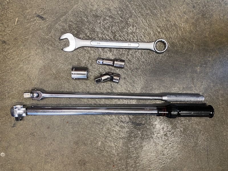

Didn't quite have a couple of tools per @MattRX post #3
  • 3/8x1/2 adapter isn't common
  • 24mm wrench isn't common. Luckily neighbor had a cheap one
  • Had a 24mm 1/2 socket in my 2nd toolkit (non in my main kit) 24mm 3/8 socket (also isn't common, my main kit ended at 22mm) would have been better as I had more 3/8 extensions and 3/8s are smaller and more maneuverable in this tight space in general.
Removal
  • box end of 24mm wrench wouldn't fit on the drain plug. Transfer case require fairly thin walled. So used the open end carefully (one hand holding open end steady on the plug) and broke loose without too much force. Maybe last change didn't tighten 35ft/lb. Anyway, it's a big wrench with lots of leverage.
  • breaker bar + 24 1/2 socket broke loose fill plug easily.
Install
  • 950mL Synth GL5 75/90
  • open end 24mm wrench on drain plug. Guesstimate 35ft/lb
  • Didn't have a 3/8x1/2 adapter (1/2x3/8 is quite common) Was able to rig up 24mm 1/2 socket to universal to short extension to 1/2 torque wrench and tighten. Need to adjust and position the u-joint on the universal to to avoid binding up on surrounding structure.
Other likely helpful tools
  • A long 1/2 extension would have helped torque wrench to reach from behind the cross member
Certainly tight quarters between
  • transfer case's long nose towards the prop shaft
  • exhaust pipe
  • subframe cross member
Have to get the just the right combo of tools in the right orientation to get this
