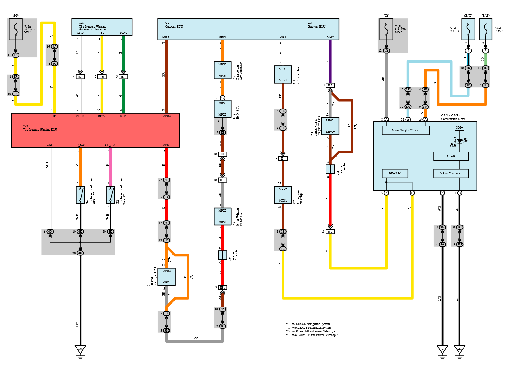

do have the schematic/diagram for 2008 rx350 black TPMS module?

Take one for the team and figure it out for us! I gave up years ago, but we'll see who figures it out first. I am more determined than ever now.
