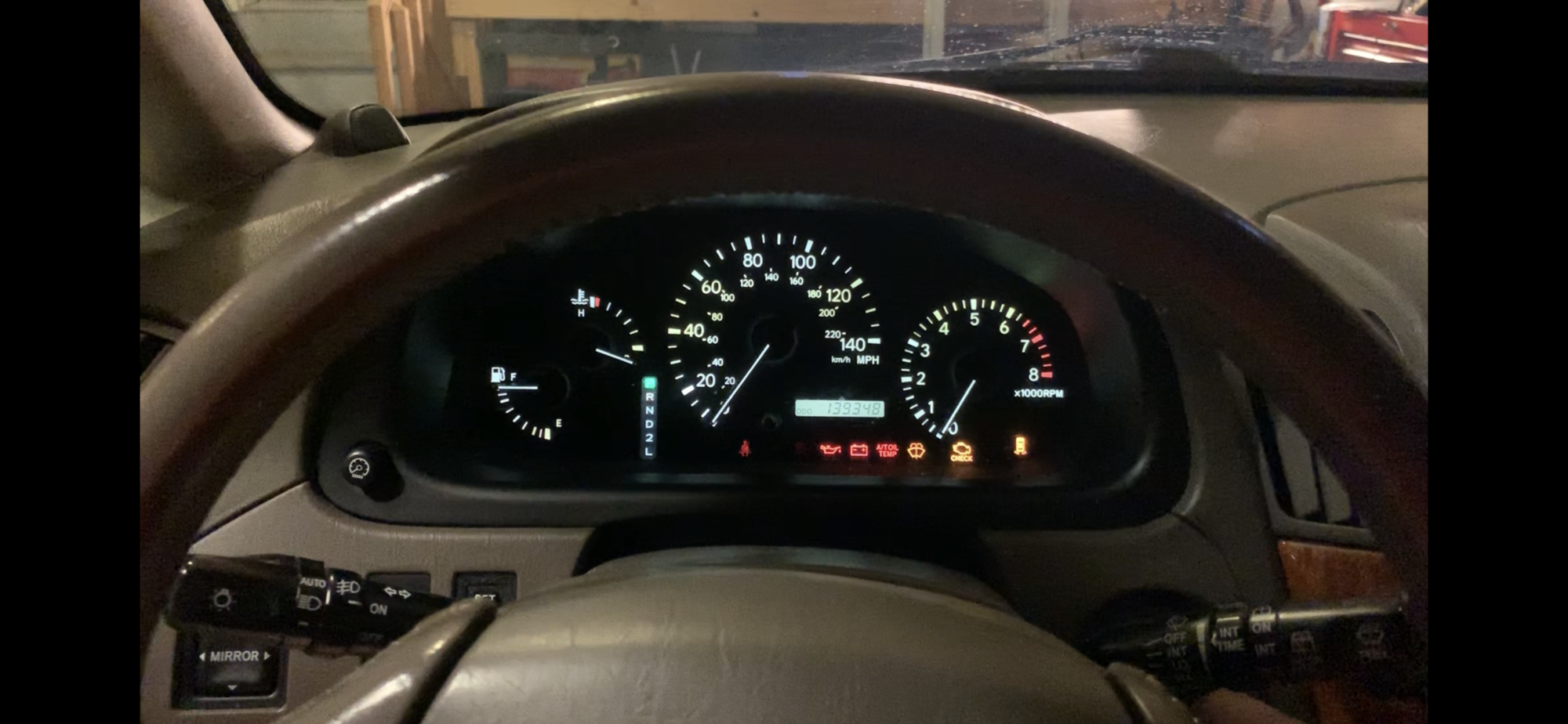

Key turned to ON position.
Key turned to START position with no crank, just 1 click sound
I’m having a heck of a time diagnosing this problem. She won’t crank over until multiple tries and sometimes I get lucky. I turn the key and all I get is 1 click and a blackout dash, with the bottoms row of lights on. I’ve already replaced the battery & alternator, I really don’t want to to replace the starter. I’ve brought it to the local Auto Parts Store and they said the starter was good. Ive cleaned the battery contacts and about to check the starter contacts. But before I do that, I thought I ask if anyone else is having this problem?
BTW, when she does start up the battery is at 14v with a load it’s at 13v and some change. I’ve attached a picture of the key in the ON position and when it’s in the START position. I tried to upload a video but it wouldn’t take it.
