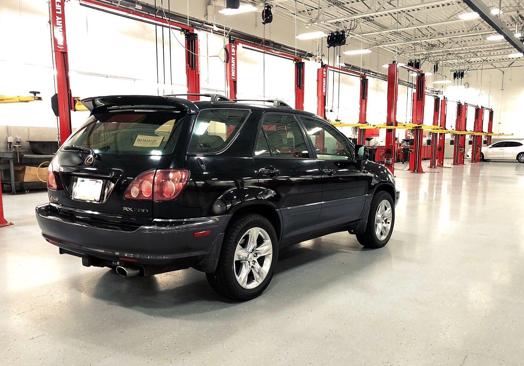

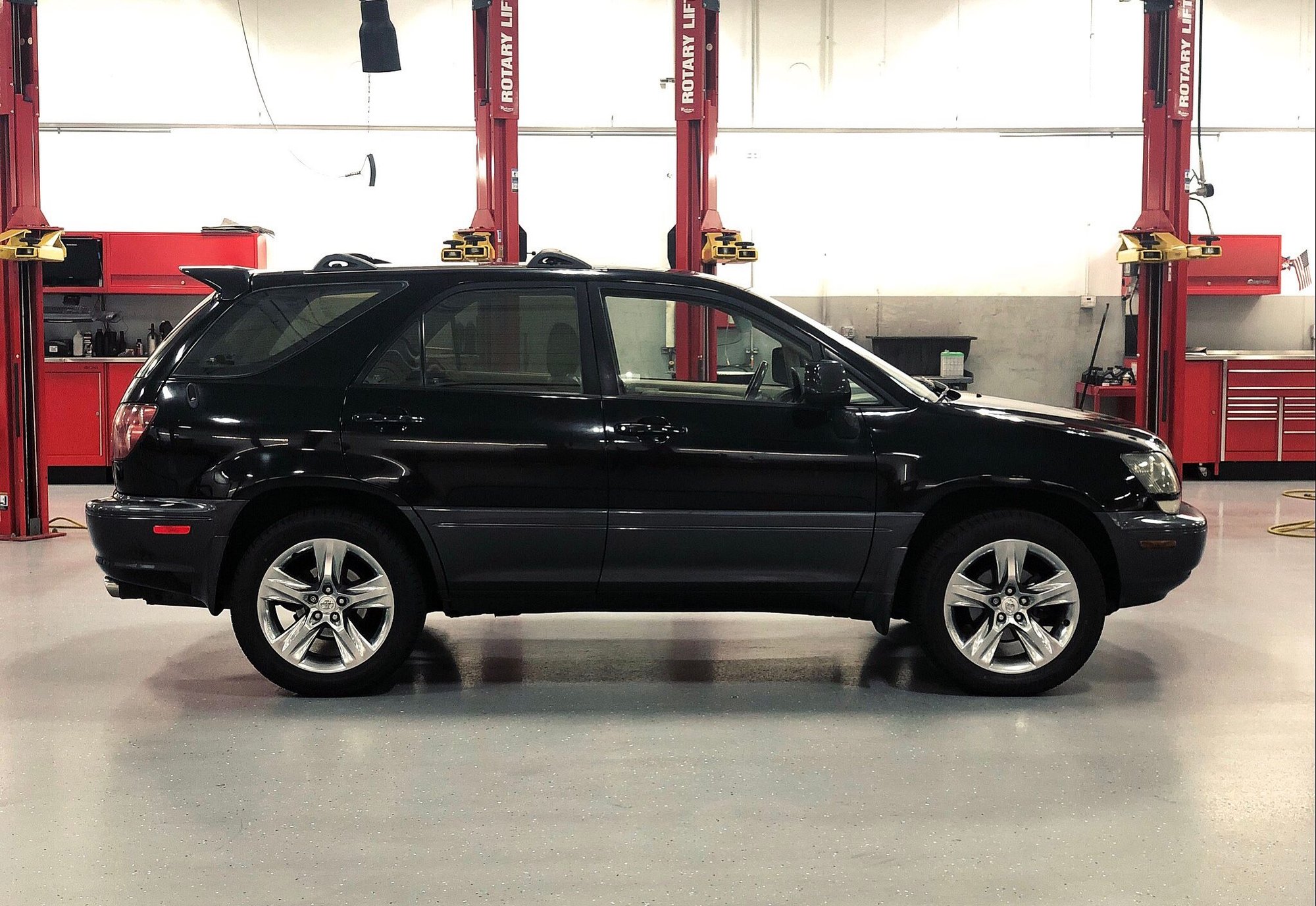

Scored a set of 19x7.5 35 offset Highlander wheels.
Fitted with 255-50-19 Kumho Crugen’s.
I was trying to get as close to a diameter as stock for the tires without loosing too much sidewall.
28.5” on stock 16” w/ 225-70-16
29” on the current set up.
2% diff. i could live with.

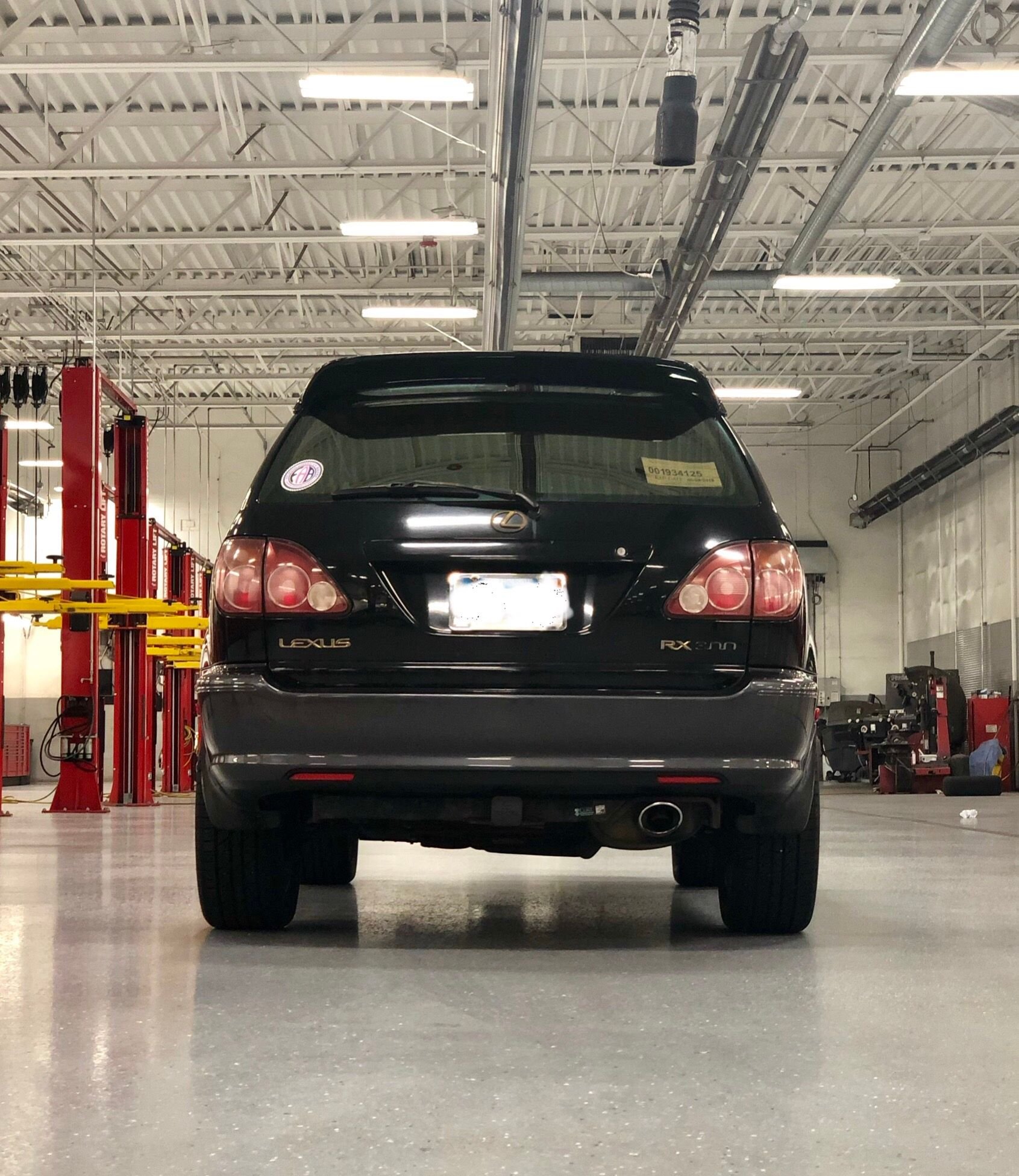

Rears cleared no problem with about 3-4mm from the strut to sidewall

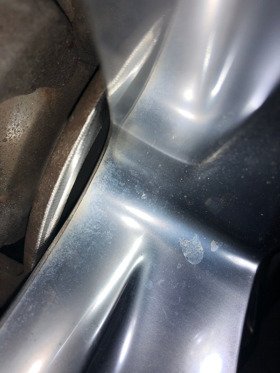

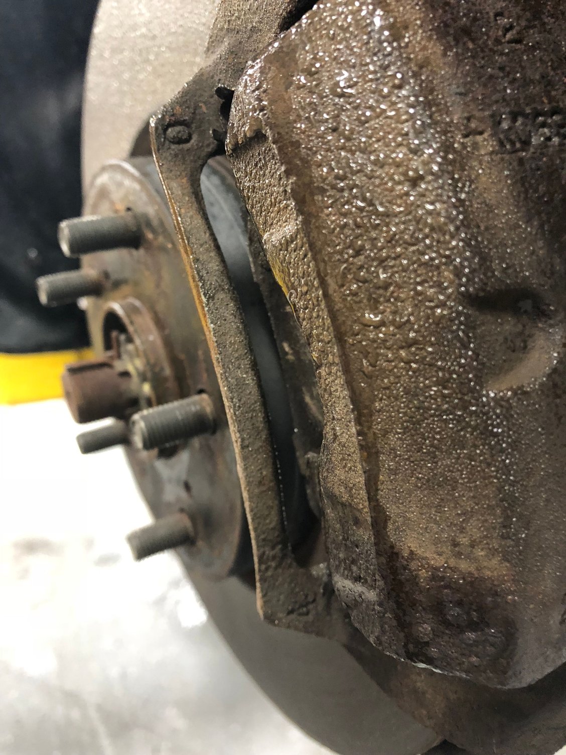

Fronts cleared except for a little rubbing on the caliper bracket.
I couldve bought some 3mm spacers but opted to just shave some material till it cleared.
340k miles and still going.

LITTLE rubbing? Are you sure you want to go that route?
No, of course not.
Thats why i shaved off some for it not to rub.
Old Dec 31, 2018 | 03:42 PM
ukrkoz's Avatar
ukrkoz
Joined: Mar 2011
Posts: 1,817
Likes: 229
From: wa
On rims? Just curious.
Old Dec 31, 2018 | 05:02 PM
Nad1370's Avatar
Nad1370
Joined: Apr 2008
Posts: 1,058
Likes: 126
Not sure what you mean but yes, the inside rim rubs the caliper bracket.
Old Jan 1, 2019 | 07:13 AM
ukrkoz's Avatar
ukrkoz
Joined: Mar 2011
Posts: 1,817
Likes: 229
From: wa
Where you shaved it a little bit. You shave rim inside, right?
Old Jan 1, 2019 | 08:25 AM
Nad1370's Avatar
Nad1370
Joined: Apr 2008
Posts: 1,058
Likes: 126
I shaved material on the caliper bracket, not the rim.
