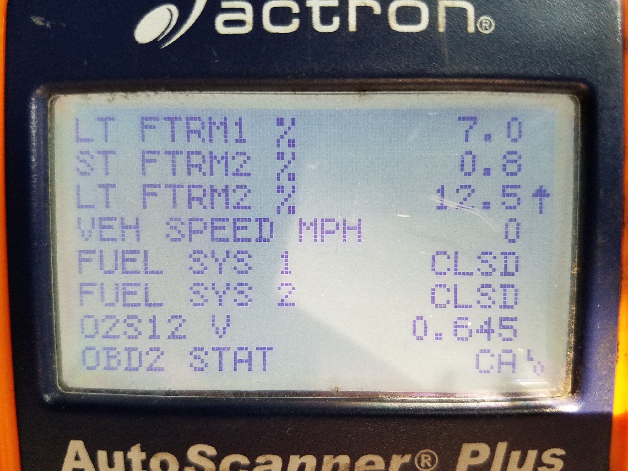

I got my cousin's Actron CP9180 and got some screen captures which is pretty much greek to me because I am not a mechanic.
FREEZE FRAME DATA:

Other DATA screen prints:

Quote: I got my cousin's Actron CP9180 and got some screen captures which is pretty much greek to me because I am not a mechanic.
What’s was different between the freeze frame pics / what code(s) were thrown for the two sets of pics? In the first set it looks like the p0330 code threw while driving, the second set looks like it was at idle but I don’t see the code that threw first.
In the first set fuel trims look fine - all close to zero. In the other your long-term fuel trims are high-ish (too much air) depending on drive conditions at the time.Those LTFT values are about what I was getting before I replaced the hose from the vac surge tank.
If it were me, I think I would want to see the knock sensor code as the primary code again before going through the $$/hassle of replacing. Maybe it already has shown up again as the first code. Whichever code keeps showing up first based on the freeze frame would be my first target.
At the same time - $720 to replace the knock sensors - verify if it’s one or both, might as well do both, and possible the harness - is a good price, I think Lexus quoted me some $1,200+.
I think the 2nd set of pics was before it threw the P0330 code viewing real-time data. It's throwing the P0330 about 10-12 minutes into any drive.
The 1st set of pics was under the FREEZE frame.
$720 is for both knock sensors and harness. Service Advisor was looking for a 2nd harness and said he had to get it from a dealer and I shot him a screen print of Salim's post that its one harness.
