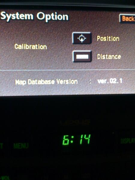

Default How to get to the Override screen for Version 2.1
This could be a repost but I couldn't find it here in the RX forum. This over ride allows you/passenger to key in address on your nav while driving. This will stop working after the car has shut off so you would have to repeat the steps below each time you want to use your nav while driving.
1. Press Menu
2. System Options
3. Should now show the map database version.
In that screen:
Press the upper left corner of the screen
Then press the lower left corner of the screen
Then press the upper left corner of the screen
Then press the lower right corner of the screen
4. Then it should bring you to the Override screen and then just hold on the over ride button until it's highlighted
5. Then hit the back button and you're done.
Attached Thumbnails List of RX300 DIYs-iphone-pics-034.jpg   List of RX300 DIYs-iphone-pics-014.jpg
