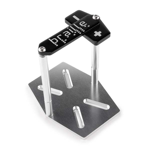

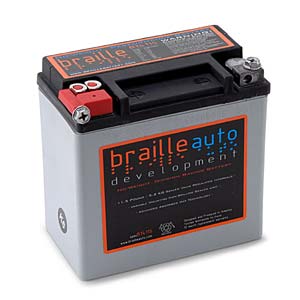

Tirerack, a sponsor of the Club Lexus, is starting to sell Braille lightweight batteries.
http://www.tirerack.com/accessories/.../batteries.jsp
Lexmex first told me these, but I did not have time to buy them before my battery went south.
Here is the bracket, weight 8 oz.
Battery, weight 6 lbs.
My Costco Battery weight close to 50 lbs
