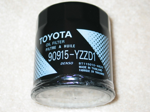

I used the K & N oil filter for my SC300 cost$12 + tax. Last saturday I picked up a 90915-YZZD1 from toyota dealer for $6.35, it looks nice and the design is A+. The filter fit both the SC and RX but I'm still waiting to find out how the filter perform before installed it into my RX and SC.

Old Dec 7, 2005 | 10:10 AM
supra_trd's Avatar
supra_trd
Joined: Nov 2005
Posts: 193
From: MN
Originally Posted by xfirechief
WHAT? How does a oil filter look nice?? Aren't they all round? The design is A+?
We are talking about a oil filter here, aren't we?
Here is the picture of 90915-YZZD1 design and lub. Now you know what I mean when compare to other filters available in the market.
