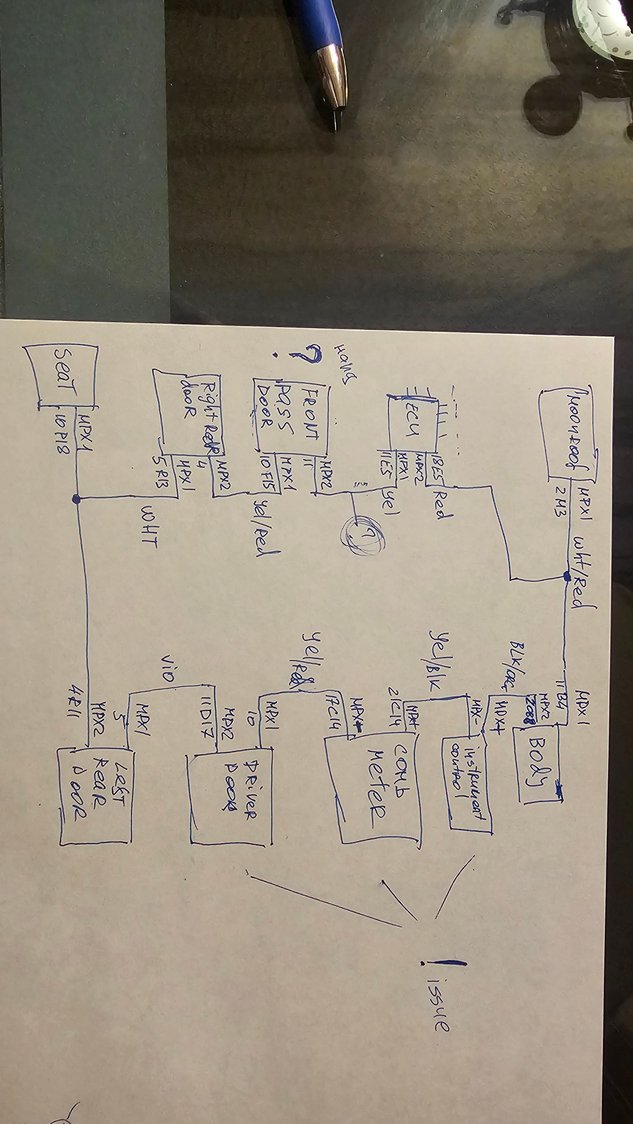

To underline, maybe someone would have any idea:
I used Autel scanner - it is more useful in this case.
When unplug body module, there is no issues related to communication hang.
when I unplug any of body sub-modules, body module detects it missing.
However, seems ECU somehow also reads some modules, even there only on MPX network. And it still detects unplugged passenger door, which cause hang communication system, regardless door connected or not.
Also, driver door, and tachometer unit, shown during test as having some issues - exclamation mark, but completely readable, until access passenger door.
Any idea where is digging?
Thank you

Last weekend I found (via oscilloscope) that there is no communication on TC line, only stable input voltage - 13.8v.
Seems there is short on power somewhere - now it would be wires check again.
Will update once get anything.
