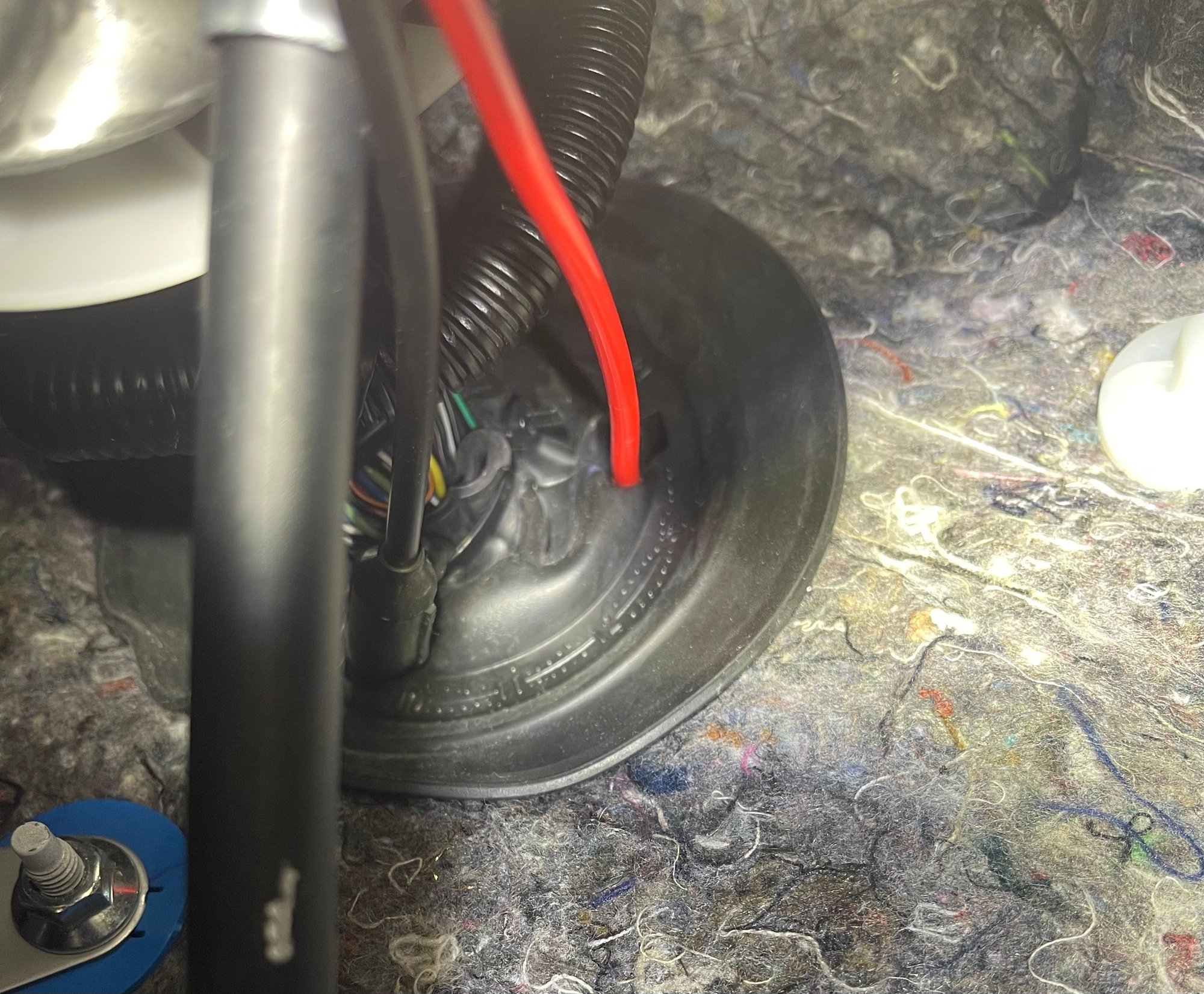

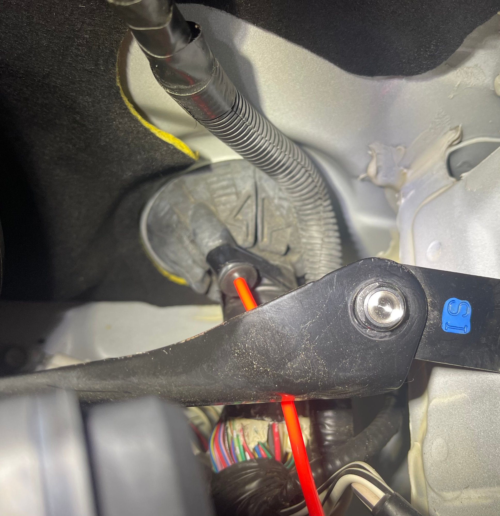

I believe there’s an extra provision for either a cable or something just to the left of the two arrows pointing up. It may be hidden/wrapped with electrical tape. The hood latch cable is routed through the same provision at the bottom of the grommet. Here’s a couple pictures of my IS F when I routed a wire for my foglight bypass wire. RC F should have that too. This is on the driver’s side but passenger side should be the same. Just punch a small hole, smaller than the wire and then feed the wire through. Good idea to make a drip loop on the wire where it comes out of the firewall.
I'll look for that provision in the grommet and make use of a drip loop (great idea). Thanks!
