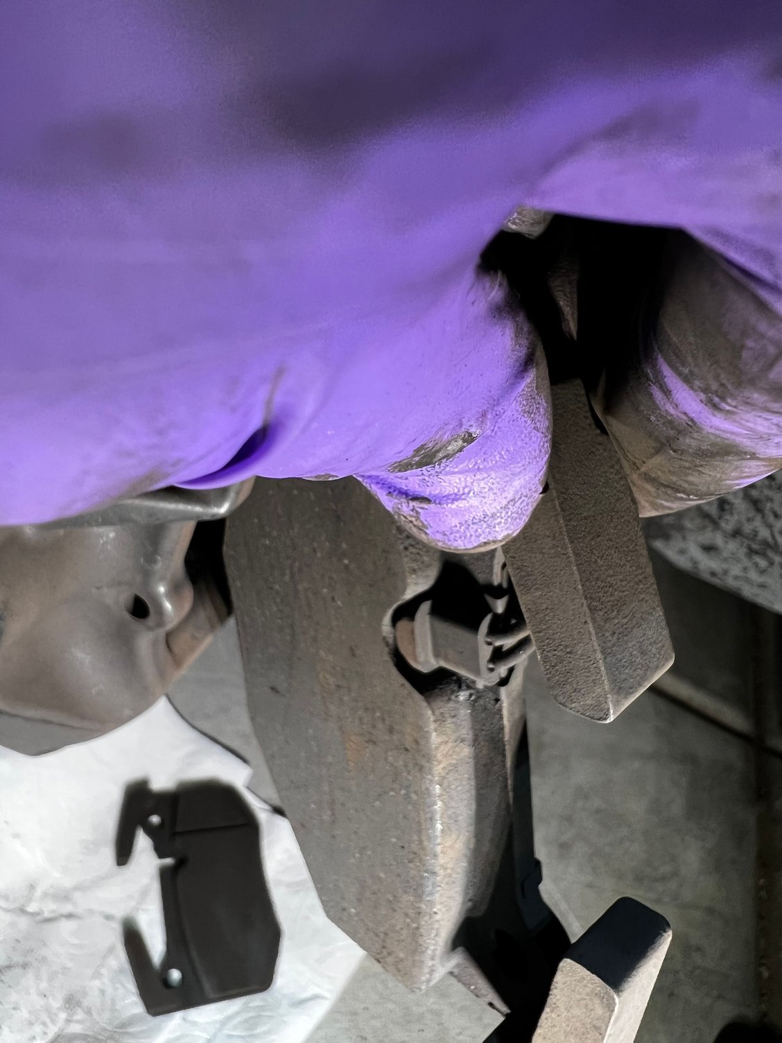

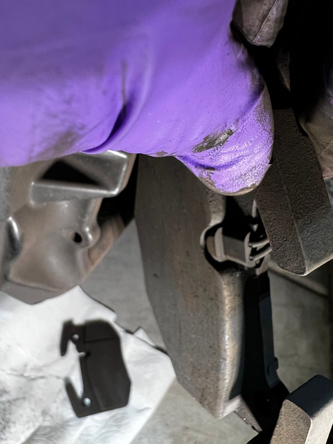

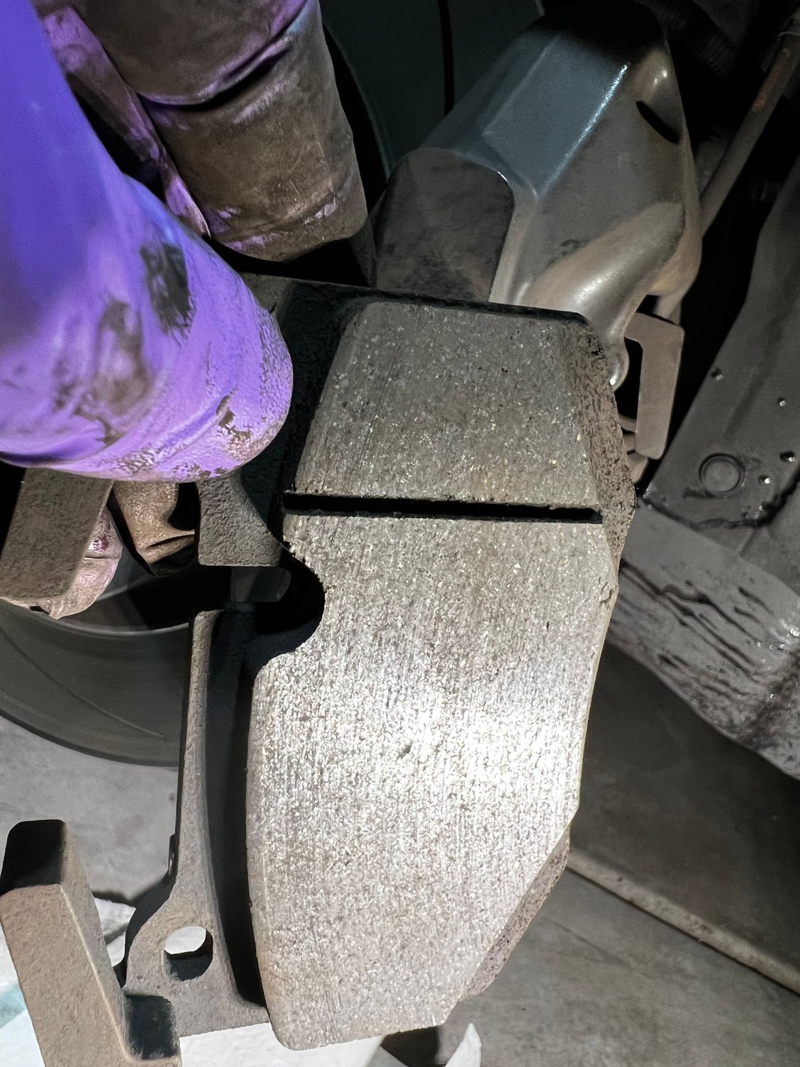

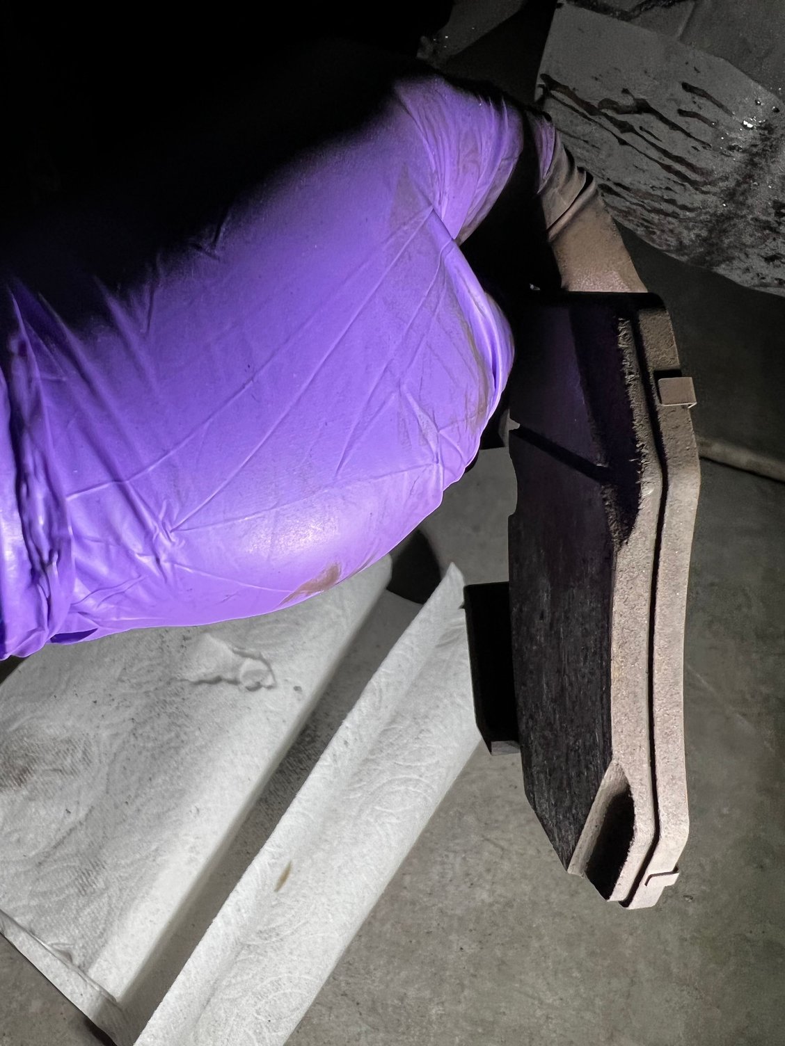

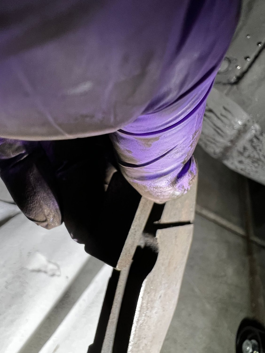

Rear Brake Pads need replacing??????

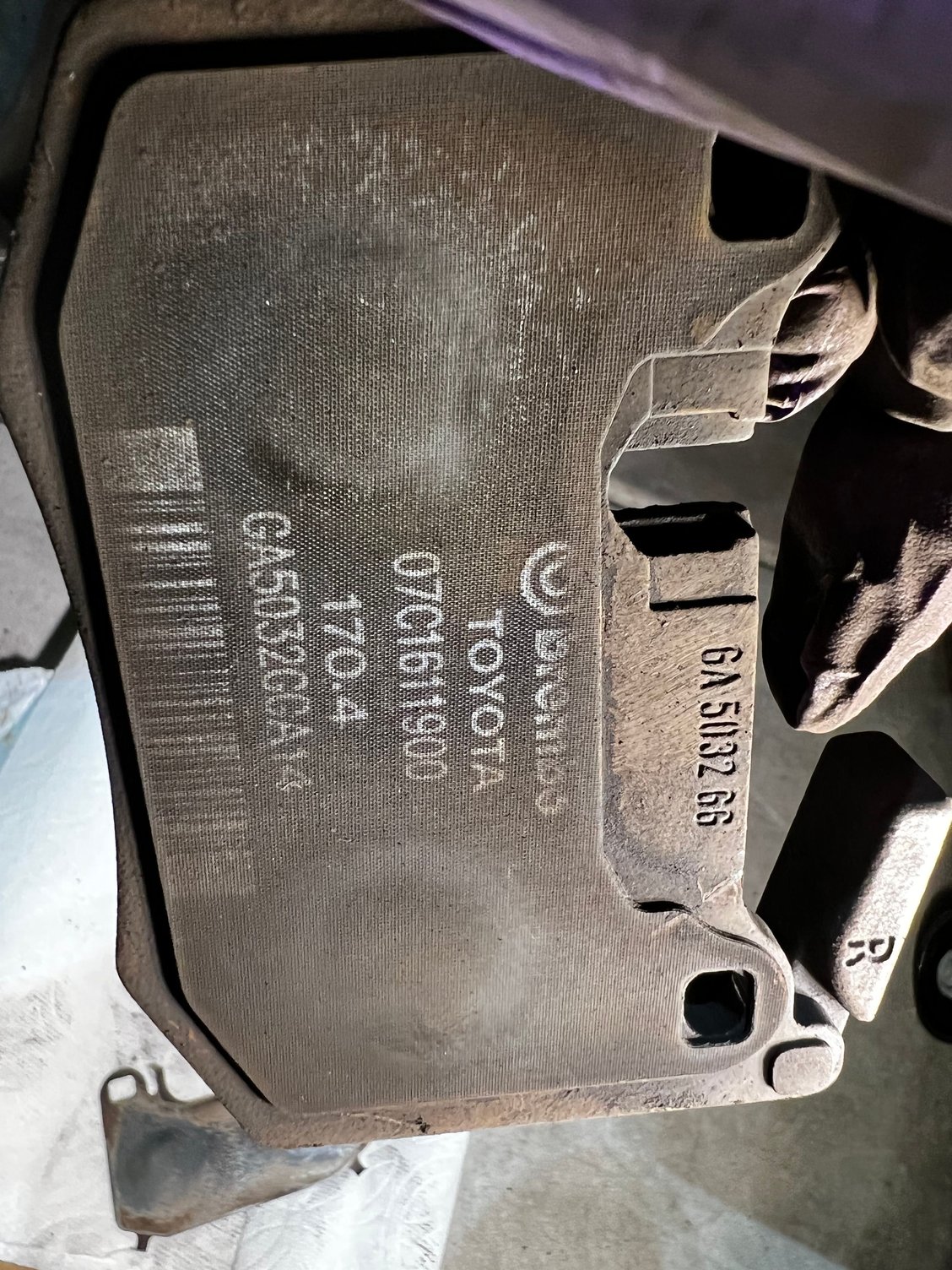

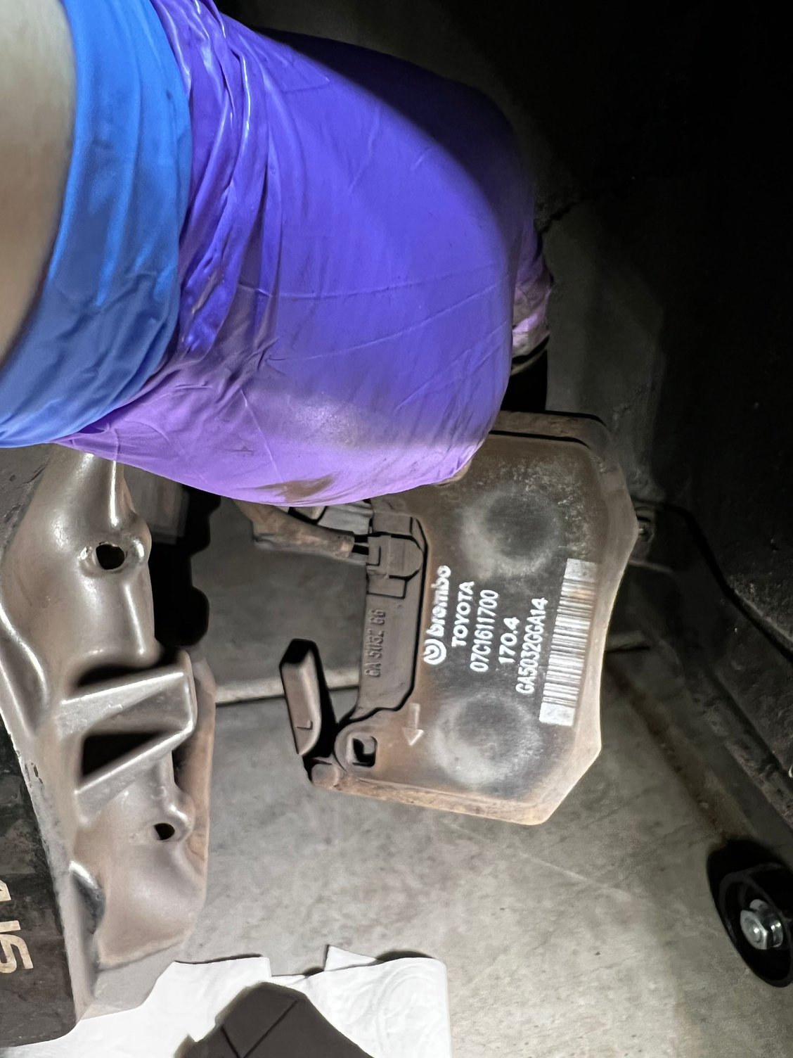

Please see attached pics.
Any thoughts?
Thanks

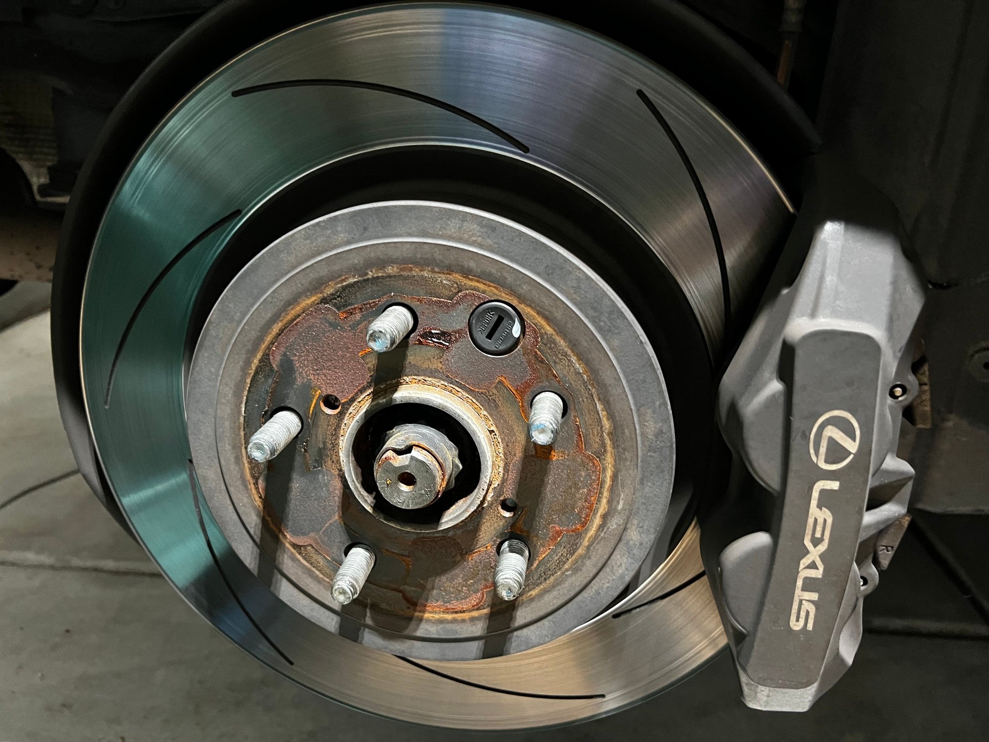

Pads still have a bit of life left in them. Got a good 2mm before they trip the sensors.
Looking at that groove, you will need to replace the rotors whenever you do finally need new pads though.

They look fine for now, just wait until the sensor tells you to replace them and buy new rotors as well.

Looks like lot of meat left
